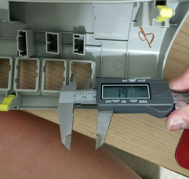

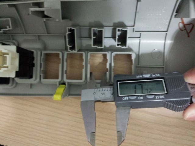

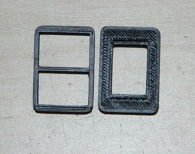

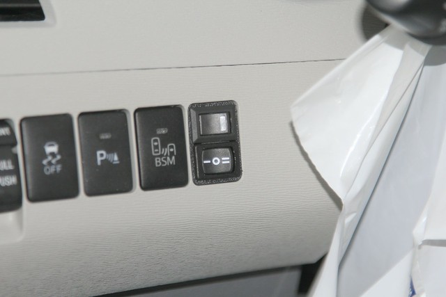

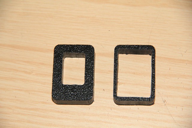

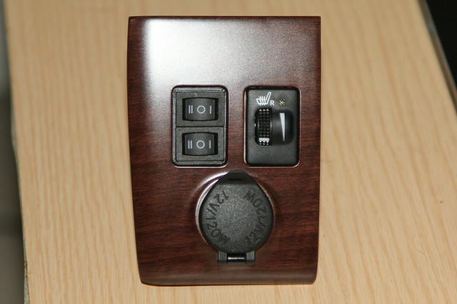

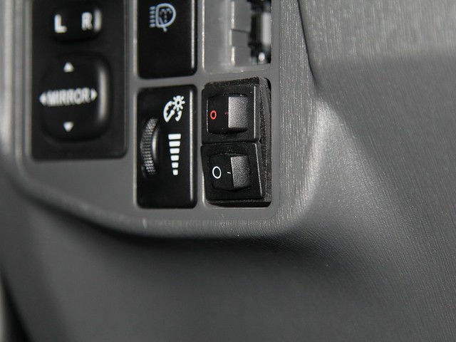

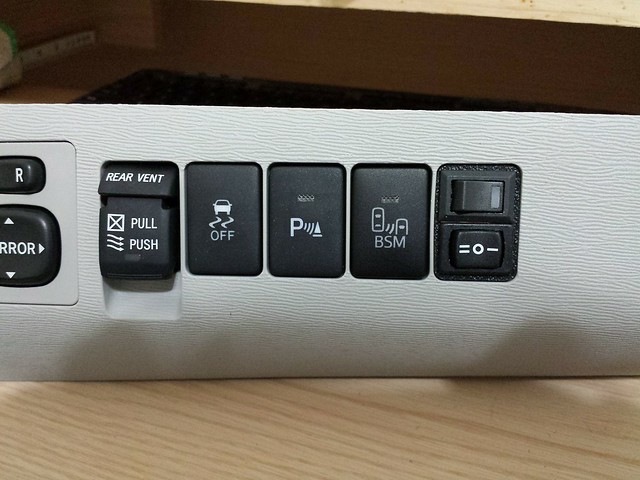

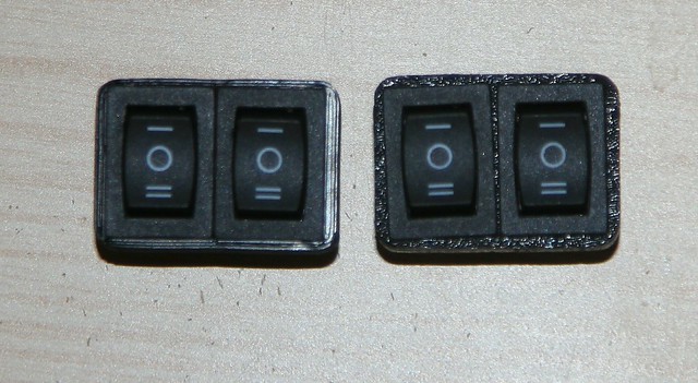

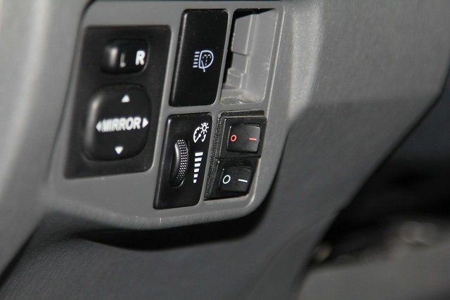

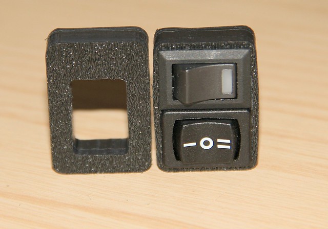

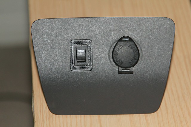

    Blank switch filler options!!! The next batch of bypass will have the option to order a single switch or a dual switch blank filler. Of course only 1 switch will operate the bypass. However, the second switch is there for you to add your own accessory. You can use any mini rocker switch with 13mm X 19mm mounting hole +/- .5mm tolerance. Switch not included. Dual switch filler option will be slightly higher cost.

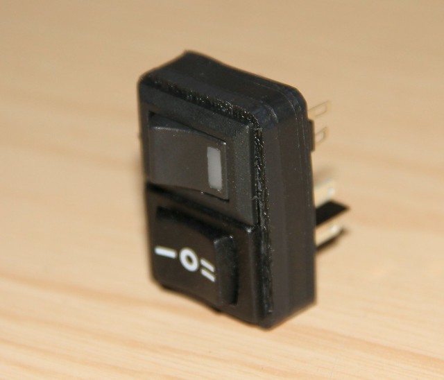

    My first attempt at dual switch in a single blank is in fall of 2010 and I failed. It still holds the switch together, just not pretty. I cut the ABS freehand and filed til it kind of fit. I didn't file the stock opening. That's why the switches don't sit flush. See second attempt on filing.
    My second attempt was in Jan 2014 for my Sienna. I took a shop made blanks and filed for 2 hours to get 2 switches to fit.
    Notice the shop made blank filler has 3 layers of ABS sheet sandwiched together.
    There's no divider for the 2 switches so when the 2 switches snapped in, the thin wall bold out a little bit.
    The stock blank opening is almost 18MM wide. These mini switches are over 19MM long. They will not fit the stock opening without shaving.
    In order to fit 2 switches, you'll need to shave the side of the hole to just over 19MM. No need to shave the top/bottom.
    Once the holes are widen, the switches and the blank fillers will sit flush and look quite nice. Please DO NOT shave the top and bottom of the hole. It is not necessary to mount 2 switches in the stock blanks. Even with widen hole, the stock blank fillers can still be inserted and fit snugly. Top switch is for the speed lock override and the bottom switch is for turn signal activated rear camera.

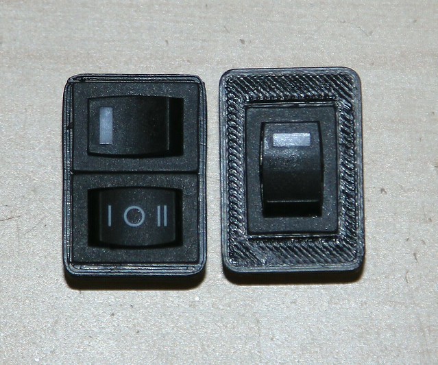

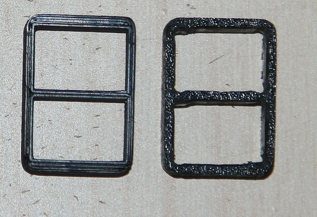

    I placed an order for the single switch and dual switch from my local plastic shop. They can make the single switch blank fillers without problems. They've tried for almost 2 months without success to make the 2 switch blank fillers. For me, it's all or nothing so I have canceled the order with them. I have since purchase a 3D printer and print the blank fillers myself. It works out better because when Toyota changes their dash switches, I can redesign the blank fillers to fit the new blanks. I won't get stuck with bunch of old blank fillers that won't fit the redesigned switches. This is my third attempt with 3D printed blank fillers.
    The single switch blank filler doesn't look pretty. I believe with a little sanding, it should look much better.
    Compared with dual switch blanks from the plastic shop. This is their 5th attempt to successfully make a functional 2 switch blanks.

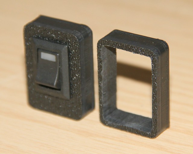

    The shop made blanks filler's switch alignment is crooked and there's a gap between the 2 switches. The 3D printed switch blank filler is near perfect with no gap.
    3D printed single switch blank filler in 2010 Prius lower cigarette lighter panel.
    dual switch blank filler in a 2014 Sienna cigarette lighter panel/seat heater panel(for fitness and testing purpose. Seat heater switch will back in.)

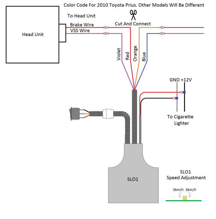

    New Speed Lock Override 1 SLO1 wiring diagram
    #192 cproaudio, Aug 17, 2014

    Hello
    Thanks cproaudio for this great build. I saw this post few days ago and followed the build instruction and now I'm putting some finishing steps to complete building a video input for my Camry SE 2014 no nav.
    I have a few questions:
    1. Can I feed the power to the bypass from the power going to the head unit?
    2. Where to connect the ground? Do I connect it to any - wire or to a ground point?
    3. How much time do you recommend keeping the bypass on? I'll use that video input to connect my iPhone and showing the maps while driving.
    Thanks again and God bless
  14. cproaudio
    cproaudio Speedlock Overrider
    Jul 7, 2010
    2,401
    762
    CA
    Yes, as long as it's switched on by the key and not constant on. You don't want a power vampire in your electrical system.
    Any good ground spot will work.
    I've left it on for about an hour before and I didn't have any problems. Keep in mind that 2014 Camry's head unit also display car info. I don't know if the head unit is merely a display for an outboard trip computer or if it uses the VSS information to do the mileage calculation onboard. Bypassing the speedlock may or may not affect the mileage display on the screen. You can check out the toyotanation's Camry aux video input thread for more infomation.

  18. MSM182
    MSM182 New Member
    Aug 20, 2014
    Sorry for my late reply. I paused the DIY for few days because I was a little busy.
    I checked the LED and it was 3V. I just picked it randomly from Radio Shack without noticing.
    I finished building the VSS and installed without testing and it works great. The diagnostic screen shows a reading of 6 kph. I want to know how to tweak it to make produce a signal for 0 kph.
    I finished the parking brake bybass, but once the car starts moving the video gets disabled
  19. cproaudio
    Jul 7, 2010
    2,401
    762
    CA
    Use 4.7uf capacitor with 1M ohm to 1.5M ohm for R2.
