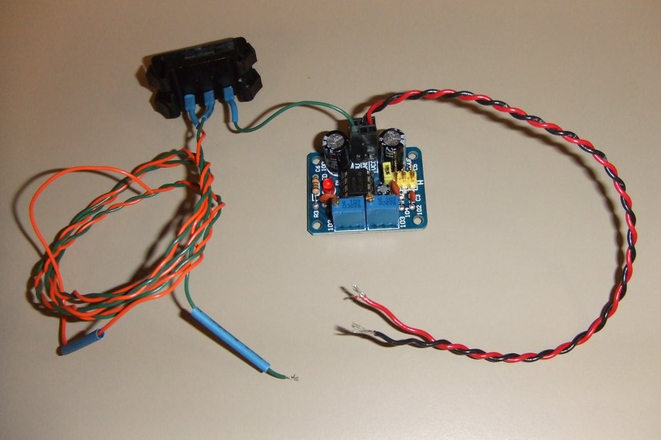

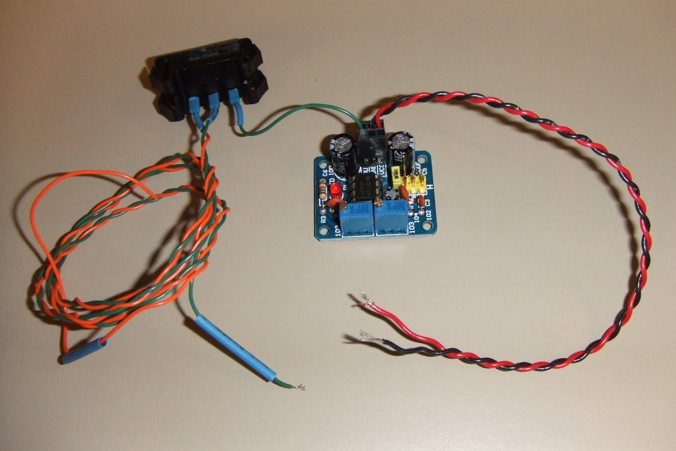

    Love it! Did the same and it works great on my 2011 Prius. I haven't put the on/off switch in yet - I will use a DPDT toggle switch so it will power up the 555 board and simultaneously switch the VSS from the board to the Nav unit to enable the bypass. This should save a little bit of power draw when the switch is in the 'normal' (non-bypassed) position by removing power from the 555 board. I may also remove the LED on the board and mount it next to the switch to indicate the bypass is ON. The flash rate (~3.8Hz) is perfect for grabbing attention as a reminder to switch it OFF after use. If there is interest, I'll post an update when I finish it up. Total cost is less than $20; great find on the 555 module on eBay.
