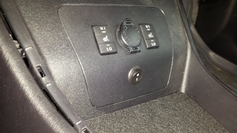

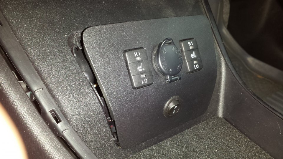

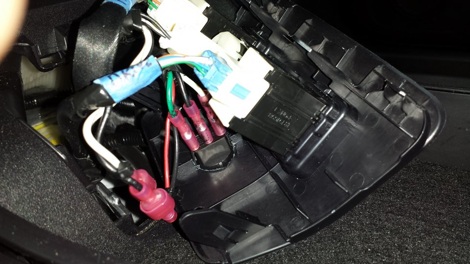

    There is plenty of room behind the lighter bezel in my 2012 PiP. That is where I installed my switch. I had originally intended to install the switch onto one of the blank plates to the left of the steering wheel. But after I pulled out one of the blanks, I quickly realized I couldn't install the switch onto it. (I made my own speed lock override harness since cproaudio sold out all of his so I didn't have one of his pre-fabbed blank plates.) It was not a shallow "plate" that I could easily drill through. It was more like an inch and a half long "plug". Besides, all of my switches were too wide for the plate.
    The lighter bezel was the next logical location. I have to say, it was not easy pulling out the lighter bezel. I tried the "thumb technique" with zero success. I tired inserting a small thin screwdriver to depress the clips, but I could tell I was starting to deform the plastic. Finally, I decided to pull out two of the side panels (where the driver's right leg would rest against) to allow my hand to get behind the lighter bezel to undo the clips.
    Below a couple of pictures of the lighter bezel with the switch installed:
