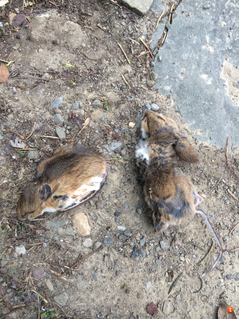

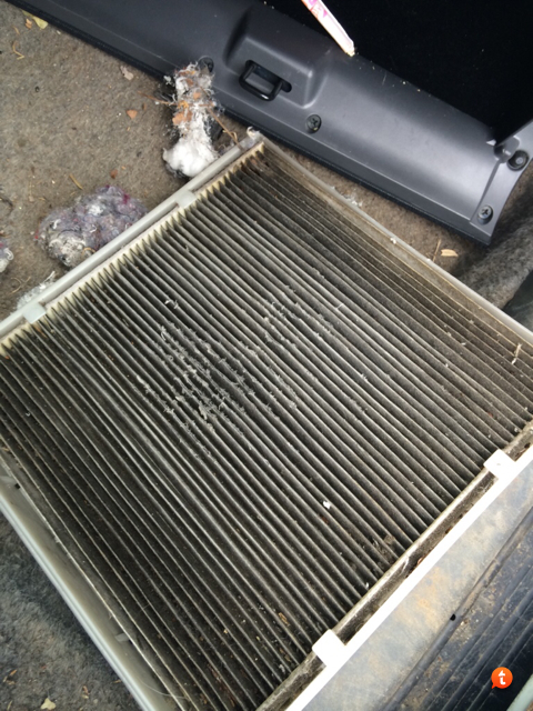

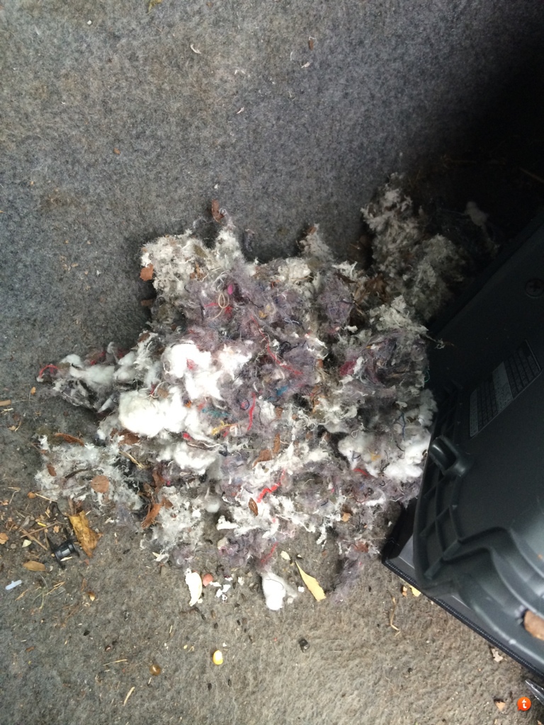

    So wife reported that there was a very bad odor in the car.
    Pulled the cabin air filter and found the following
    iPhone ?

    16,936
    8,646
    now look for the mom and pop.

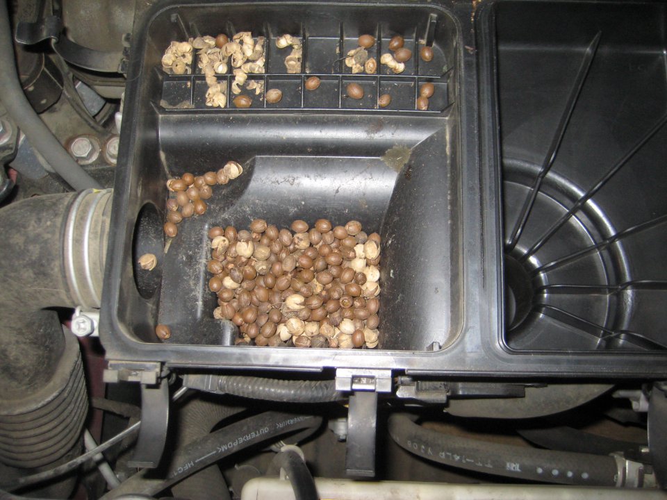

    Actually, I was being a bit flippant when I said that half the time mice will make the engine filter box a storage pantry. Maybe about 15 percent of the time....
    Wonder why those mice were dead though.....In the old days they got chewed up by the fan, but the Cabin Filter usually keeps them out of the fan....and in this case, there is no hole chewed in the filter...
    Strange. In my experience, from now through June is the worst time for the rodents. So, if you are getting some now, odds are, you will get some later.
    Mine, earlier this year:

    There were two holes in the filter.
    iPhone ?

    Aye, can't see the holes in your photo....check my photo that I just edited into my post above yours to see how they treated my engine filter area this winter.

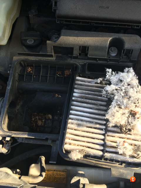

    Still a good idea. When I had mice dragging things into the cabin filter, they were also filling the engine air cleaner box. :)

    Yep they in the air filter also.
    iPhone ?

    Yep, at least you found it before it caused any issues. Patrick Wong gave me a tip of disconnecting the hose at the box and using a shop vac to get any debris that still might be "in-line."
    Takes a few minutes to disconnect and connect, but at least I felt confident that I got rid of anything in the system.
