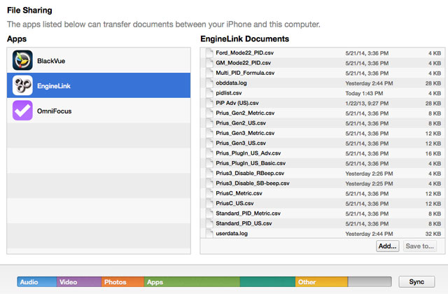

    Before connecting to the ELM327 on your iPhone: connect your iPhone to your computer and using iTunes' file sharing, add the PID file Prius3_Disable_RBeep.csv attached here, or if you know what you are doing already, add the appropriate PiP config PID file from this thread. Add the files to the EngineLink app and sync.

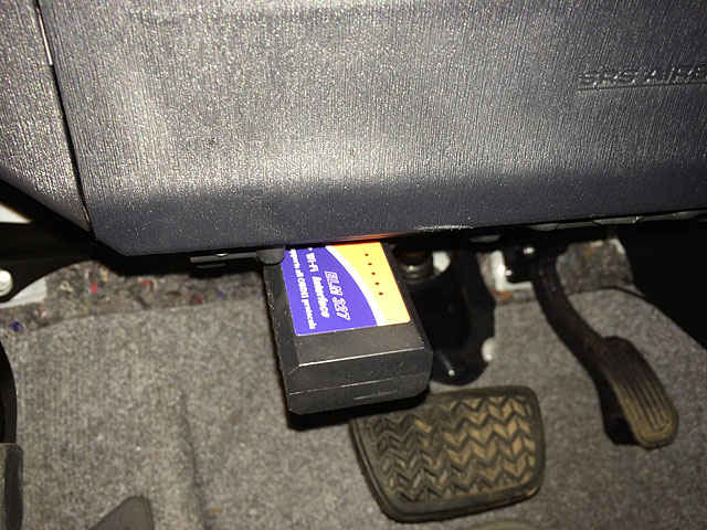

    When the WiFi ELM327 arrive from Amazon, I ran into problem #2, the CD is a small one, and it's destroyed during transit. No matter, found set up instruction on this site. It's not a full plug-and-play but I managed.

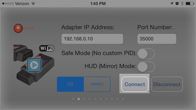

    Turn on your car. What the instruction differ from my experience are the SSID name is "OBDII" instead of CLKDevice, and it requires a password to connect, which is "12345678" (If you scroll down on that page you'll see a comment about this). But after I plugged in and launch the app, I was able to tap the "Connect" button and it connects without problems. elm-327-plugged.jpg

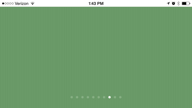

    Swipe right several times until you get to a blank page with a message on the upper left corner "Long press to create or move the custom PID". My screen background color is different because out of frustration of being stuck at this stage I was just trying something else to make sure the app isn't broken.

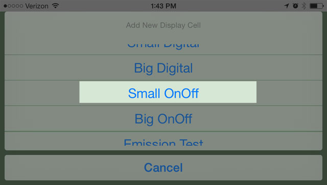

    long press until a menu "Add New Display Cell" appears. Select whatever you want but I choose "Small OnOff"

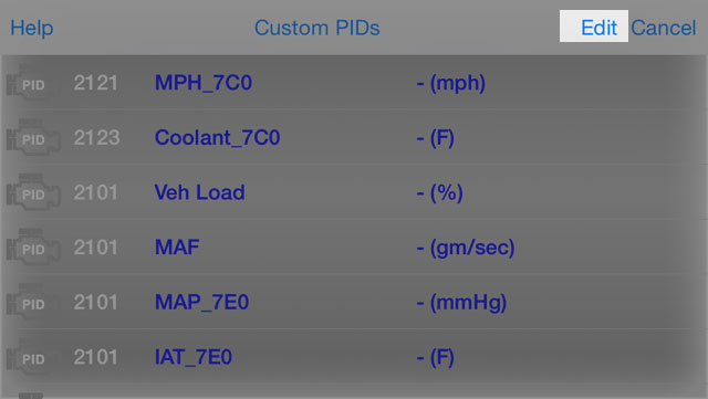

    "Custom PIDs" screen appears, press "Edit" on the upper right corner...

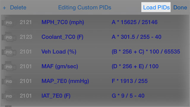

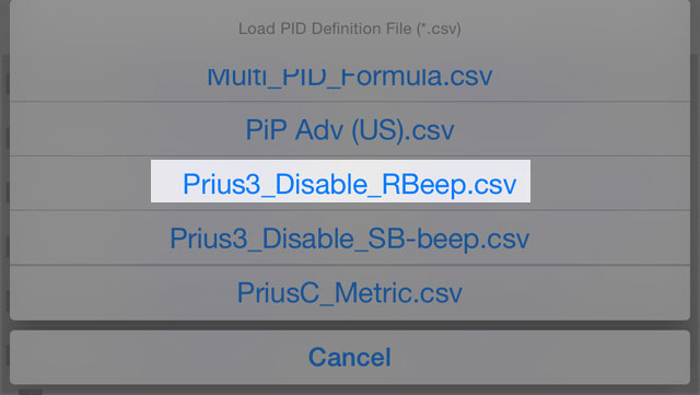

    Then press "Load PIDs" on the upper right corner

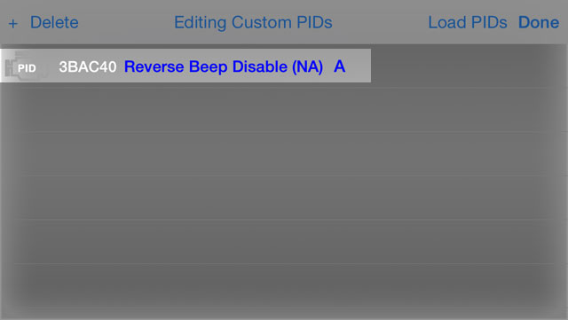

    Swipe down until you see the file you sync-ed from iTunes file sharing, in my case, it is "Prius3_Disable_RBeep.csv"
    Tap the "Reverse Beep Disable (3BAC40)"

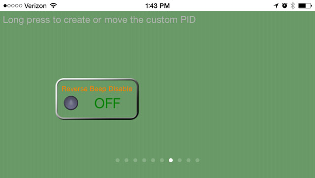

    If you see this new button on screen, you are really done. When I was trying the PID file from usbseawolf2000, I got stuck because, at no fault to him, I loaded both the disable and enable, thinking I just load the gauge and I'll be able to tap and enable or disable the beep. Wrong! I was such a n00b that I just don't understand how PID works. Turns out all I needed to do was to load the Reverse Beep Disable PID instead of both (duh!).
    Put the car in reverse and if you hear only one beep, you did it successfully.
