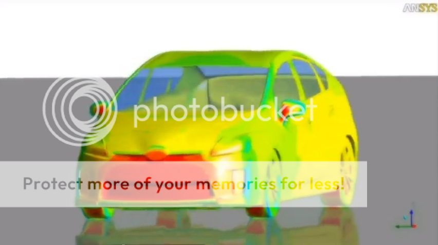

    Well, to keep the car level you could install an air suspension. I have no idea how extensive that would be, or if it's even possible, having never touched one myself. For brake cooling/thermal management, the best thing to do would be install larger rotors to get a bigger heatsink, but that won't be possible. If it were me, I would start by using a good brake fluid with high dry and wet boiling points (I like the Valvoline DOT 3/4 Synthetic, as it performs very well and is widely available at auto parts stores, unlike Motul and others). Then, I would probably experiment with flexible ducting to get air to the brakes; you can find kits online or just fab one up from hardware store stuff. You'll want to run it from a high pressure area in the front of the car, which will mean either cutting openings in the bumper cover or cutting up the existing radiator shielding to take air from the lower grill.
    Gen 3 pressure distribution shown, but Gen 2 will be roughly the same:
