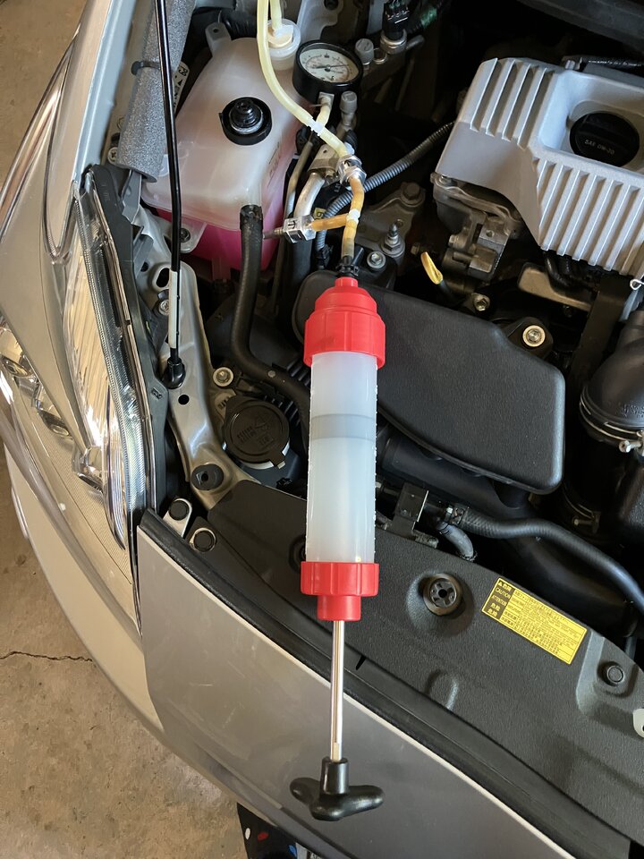

    For pressurizing the cooling system, removing the engine coolant reservoir cap and replacing with a one-hose stopper connected to a pressure source is one way to go. A crude gizmo I've cobbled, yet to use for this application though:
