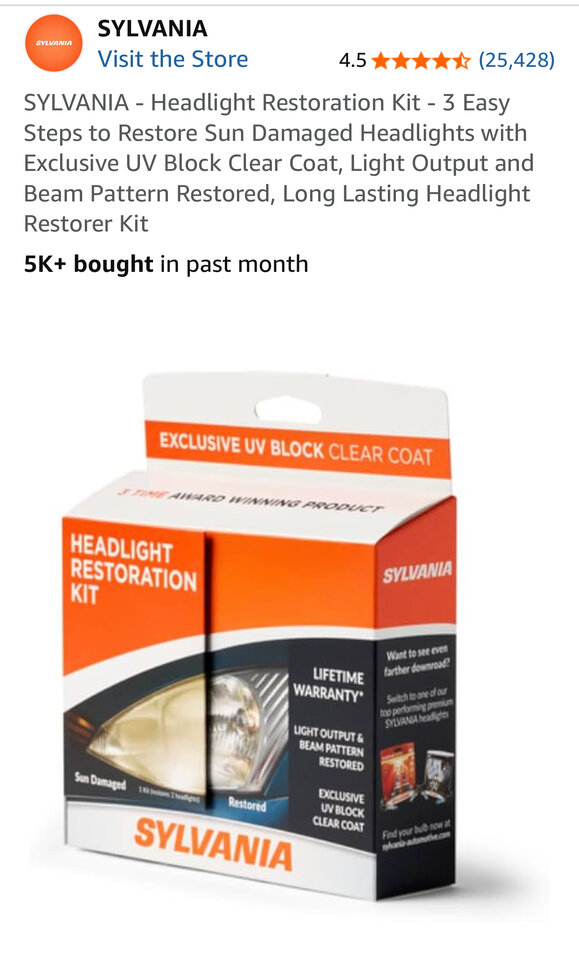

    2012v through 2014v are the same. 2015v through 2017v were a refreshed design.
    Aftermarket headlight assemblies are available some as low as $120 a pair. I might consider those as well.

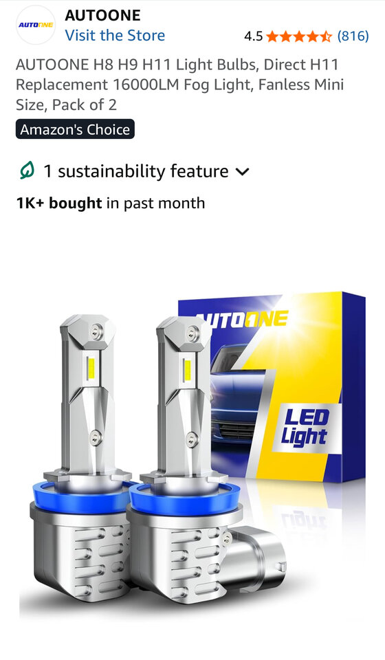

    When it comes to improved light output I think a led bulb makes a significant difference.
    $22
    Headlight cleaning kits work well but may fade in a year of two. This is my go to $22 Sylvania kit.

    Thanks! I'll check out the aftermarket sets - didn't realize they were that affordable. We did the Sylvania kit Sunday (to get the car through a Maryland state safety inspection). It helped a lot, but they're still both a bit cloudy (and nowhere near as clear as my wife's 2014). I'll check out the LEDs, too.
