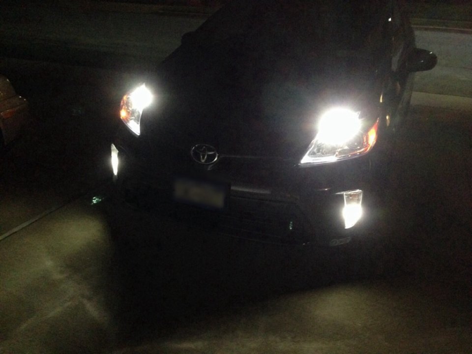

    Ok...so I bought Kolite High Power Warm White 5000k bulbs to replace my parking lights. Great reviews on Amazon, and they are bright! Perfect white with no hints of blue - match my DRLs perfectly.
    It's a Korean company, but fulfilled by Amazon...so shipping is pretty quick. Here is what they look like with the DRLs:
    Now for the New Brights LED Headlight Kit. I bought these off of Amazon, sold by New Brights. It is warranty eligible if you buy it directly from New Brights. I got some great customer service via email from [email protected]. You can email him if you've got any questions or concerns.

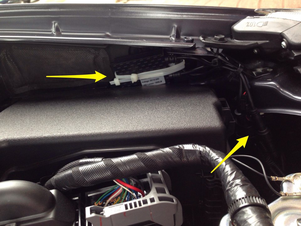

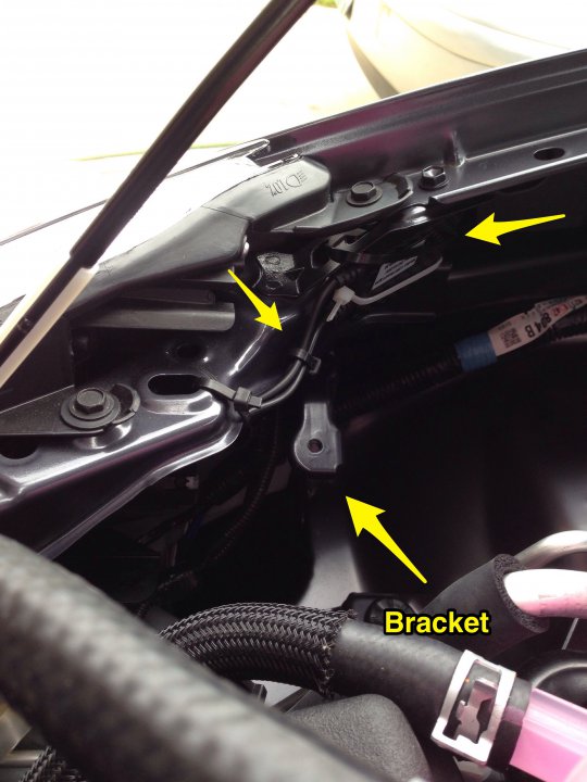

    For the driver side, I had to remove the fuse box cover. I found an HID kit video on YouTube where the guy removed the plastic cover adjacent to fuse box and tucked the ballast behind that plastic cover. I tried that, but the wiring from the ballast was not long enough, so I ended up mounting it onto the fender with zip ties. There are screw holes on the ballast, so I fished the zip ties through those holes. It's nice and secure, and the wiring is zip tied as well:

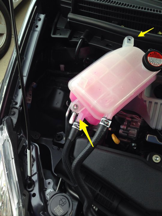

    For the passenger side, I needed to remove the coolant container. There is absolutely no clearance to get your hands anywhere near the bulb without removing the container. A 10mm socket is required to remove the container (2 screws):
    Once the container is removed, there is ample space to work with. There is a bracket underneath the coolant container that sits directly behind the bulb. Removing the halogen bulb was no problem - enough clearance. However, there is not enough clearance to slip the new LED bulb in. I had to bend the bracket slightly backwards in order to get the LED bulb in. Be careful - the bracket feels a bit flimsy, and can easily crack if you manhandle it:

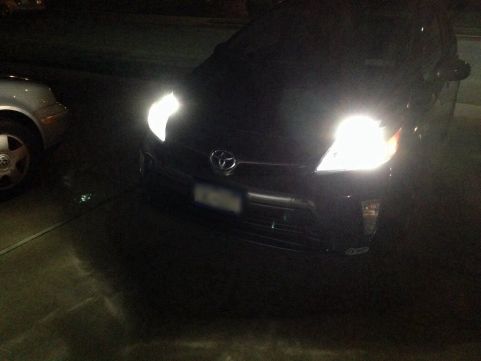

    Same as the driver side - I zip tied the ballast to the fender and neatly zip tied / tucked the wiring. Overall, the New Brights are an extremely easy plug and play kit. In fact, it took me longer to remove and install the coolant container than installing both ballasts and bulbs! Here is what they look like on:

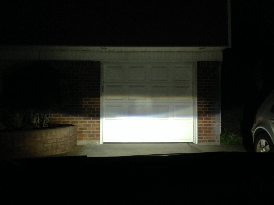

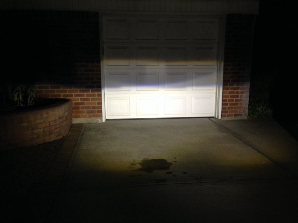

    I haven't had a chance to drive the car around tonight, so I can't comment on the lighting while driving. But here are some pics of the light against the garage. Seems acceptable to me. First pic was taken outside the car; second pic was taken from inside the car in driver seat:

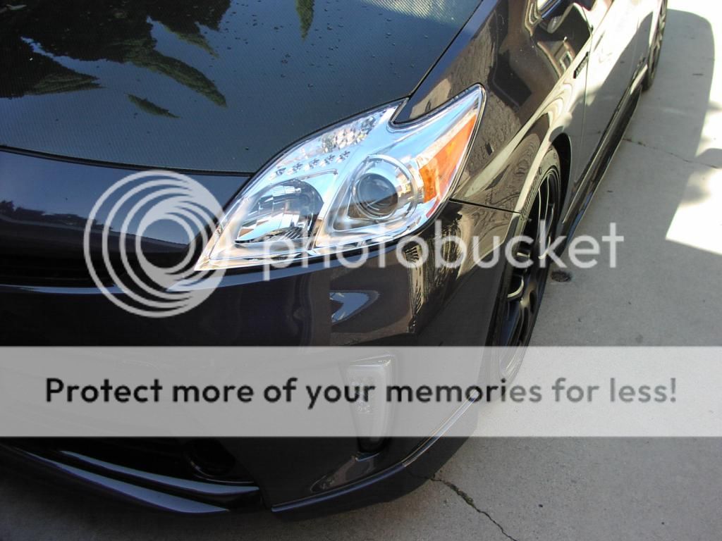

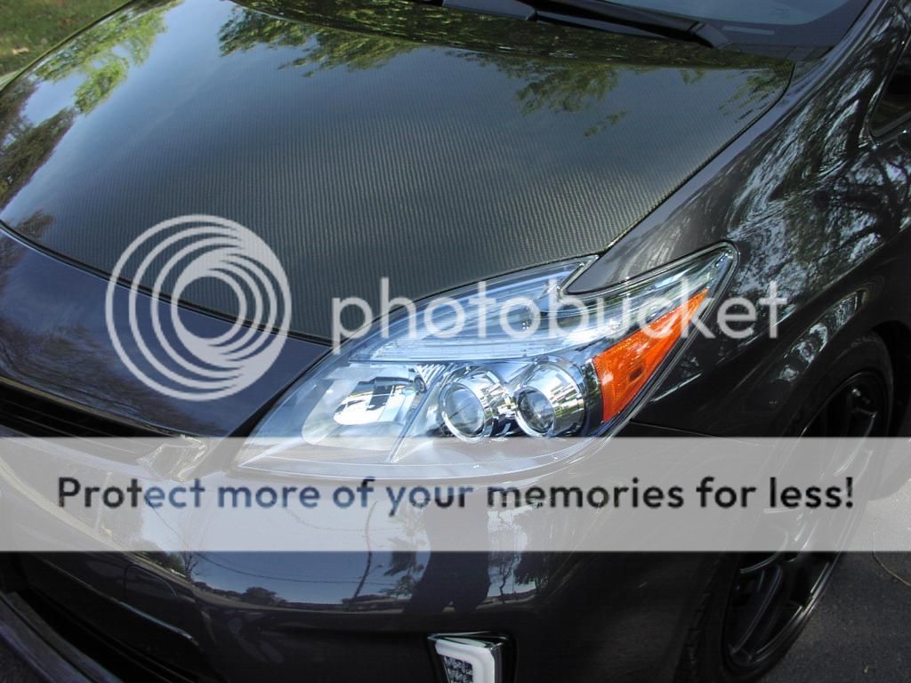

    I had the swap done just cause I thought they look cool. :rolleyes:
    Gunjee and thenapolitan like this.

    Those look awesome man. Looks like you changed the entire housing, right? I noticed the Renier DRLs...can you attach some pics of them? Every pic I've seen with them on doesn't show any definition of the strip (like the Audi, etc.). They just look like one solid light; perhaps because they're too bright? With the lights off the strips are easily visible. Again, because I haven't seen some really good pics...
    Are they plug and play (just using as DRL; no mods to stay on with headlights or anything)?

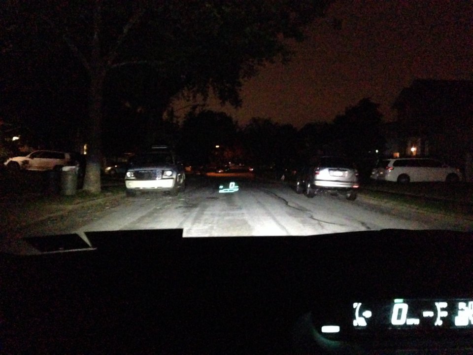

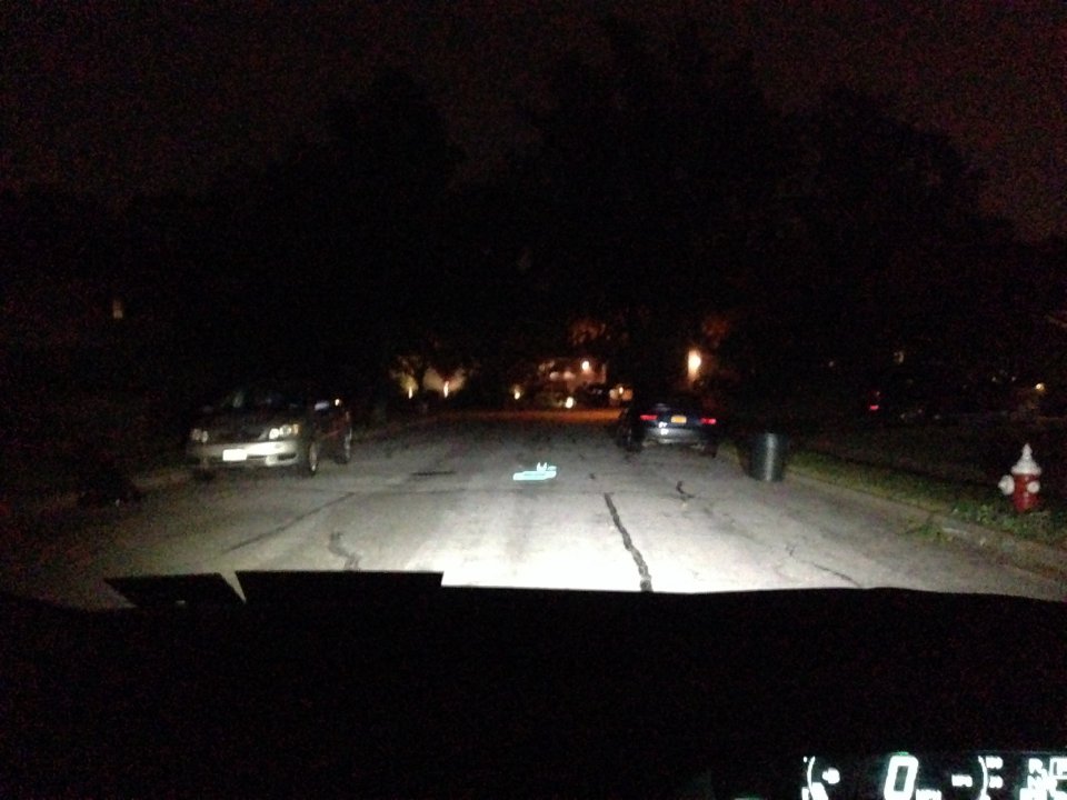

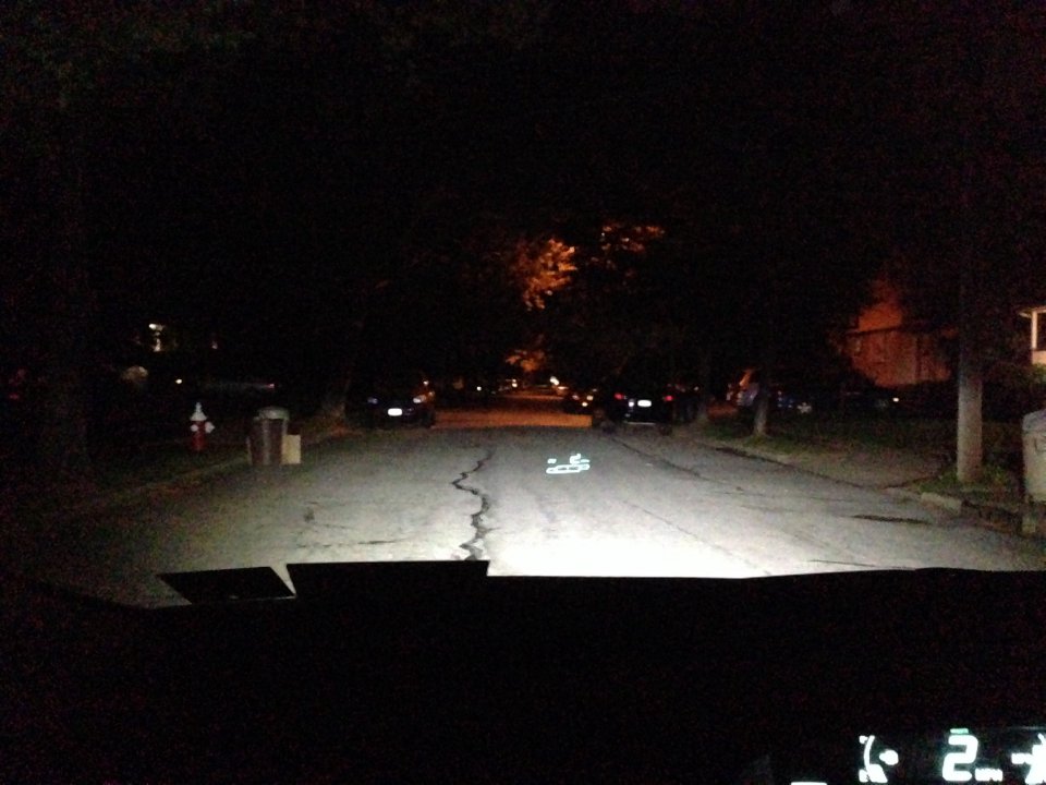

    image.jpg image.jpg image.jpg So here's an update for anyone that's interested. I went around the neighborhood and took some photos. I don't live in the boonies; the streets are fairly lit.
    The lights point down towards the road and not straight ahead. The road is clear and bright with these lights, but they don't seem to brighten up the road in the distance - I don't know, perhaps I'm used to halogens and need to adjust. I just assumed that the entire street would get lit with LEDs. When I turn on the high beams, the entire street glares (the high beams are still halogens). I guess that's because high beams point straight ahead...
    I'm not disappointed by any means and am completely satisfied with these lights. As I said, I just need to adjust - I've never driven with HIDs or LEDs, only halogens...
