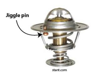

    This any help?

  5. ChapmanF
    27,575
    18,160
    The link in #441 refers to a Honda service bulletin with some of the adventures that can involve jiggle pins. The takeaways seem to be to always position the stat so the pin is where the engineers planned it (that should be easy on a Gen 3 where the stat is integral to the elbow), and not letting it get hung up on gasket material, etc.

    Here is the jiggle pin, looks
    Like I’m a bit late on the pics.
    C062D71B-0B57-4483-8D1E-96567D6587A5.jpeg ECFD6E74-2D7B-4947-8073-134F4319254F.jpeg 1DEF5510-3DA5-431B-932D-010F0405C20A.jpeg
  8. Mendel Leisk
    60,224
    41,428
    So the jiggle pin is one-way valve, the head lifts (to allow trapped air to escape) but if there's "downward" pressure on the head, it stays more-or-less sealed, won't allow coolant to flow prematurely?
    I'm just thinking removing this will help help, as far as dealing with trapped air, if the jiggle pin was not functioning properly, but it will also make the thermostat "leaky". Maybe no big deal?
  9. ChapmanF
    27,575
    18,160
    Seemed like that Honda service bulletin was about some jiggle pins getting wedged open and delaying warmup. Guess that was enough of an issue to warrant a service bulletin....
