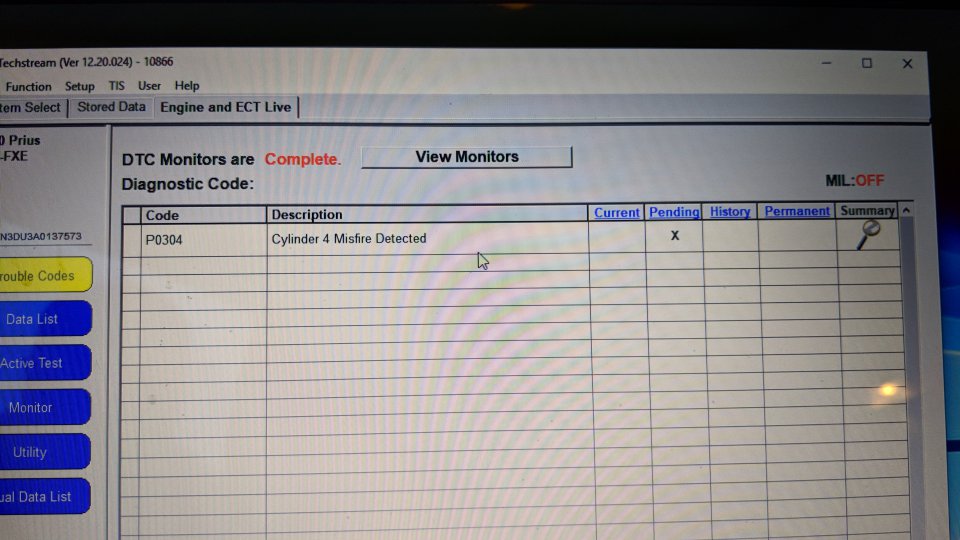

    Not sure where do I find that? Also when does this prius warn you it's overheating? It got to 122 i Pulled over shortly after.
  12. ChapmanF
    27,590
    18,182
    Data List is one of the buttons at the left of the window, after you've selected "Engine and ECT".
    Celsius? Yikes.

  16. ChapmanF
    27,590
    18,182
    Data List, buttons on the left, second from the top.

    I see this is in the techstream
