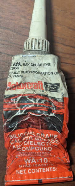

  10. ChapmanF
    27,587
    18,175
    I have a large years-old tube of "silicone brake caliper grease and dielectric compound" which I actually don't use on my brake calipers (I use the Toyota specified greases there), but boy is it the ticket for making too-small hoses go on too-big things. Such a small amount works, you don't even need to be able to tell it's there.
