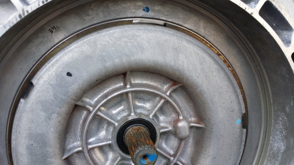

    I just came back from the salvage yard where I bought my transaxle, I didn't notice this until now that it's sitting close to eye level in the back of my Prius. Is this transaxle damaged? There is a break in the metal part, I have attached a photo. It's at 12 o'clock, about 2 inches long. I'm not sure if this break is suppose to be in the design, it doesn't look like it was cut.....now I'm worried.
  13. Britprius
    Britprius Senior Member
    Jun 14, 2010
    5,194
    1,922
    Herefordshire England
    That part is a circlip and is perfectly normal.
    John (Britprius)
    PriusGuy32 likes this.
  14. JC91006
    JC91006 Senior Member
    Nov 10, 2013
    16,924
    8,635
    What a relief :D . Thanks
    Britprius likes this.
