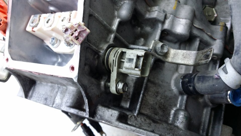

    I've looked at all the sensors on the transaxle and there are only 3. I've also removed the connectors as one of the connectors on the replacement transaxle is damaged and I have to change it. It's an easy swap, just unplug and plug back. It's not buried inside the transaxle, the electrical connectors are right where you unbolt. I believe they all have 8 electrical contacts to them. I'll have pictures later.

    The sensors are buried deep inside the transaxle, you would have to take everything apart to get to it. The question I had about changing the sensor, I may not have understood the seller, he may possibly have meant the connectors are broken. I don't see how the sensors inside can be damaged, it's buried inside.

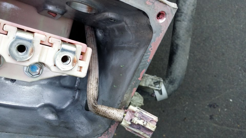

    I was wondering if the connectors are broken, not a bad sensor myself. Used transaxles rolling around in a truck bed break the sensors frequently. Rebuilt transaxles come with broken sensor plugs at times too.

    Many breakers do not disconnect the many electric cables going to and from the transmission cutting them instead. This could also be an explanation of the broken sensors.

    I changed out the connectors on the replacement transaxle with the ones from my car. The ones on the replacement were very dirty, it was very easy to swap them out. There was 1 plug that had lots of thick gel on it, looked a bit like thick yogurt. It was a bit pinky/violet in color. Maybe it's used as an insulator.

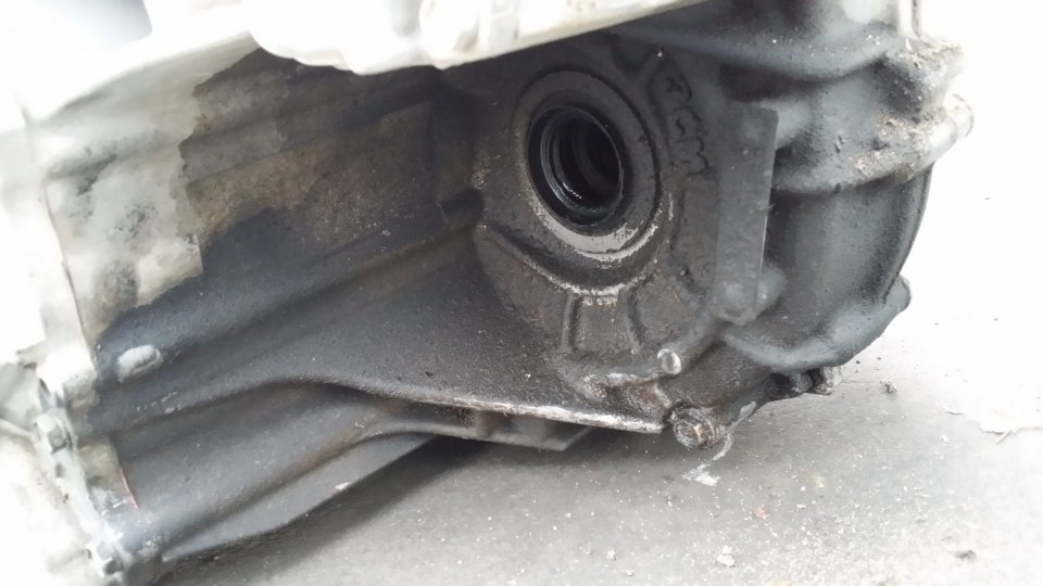

    I'm going to be taking this transaxle apart this coming week to get to the MG2 and see the damage inside. I noticed the transaxle had what appears to be a really bad leak around the seal. I looked through all the dealer service records for the car but there was never any mention of a seal leak. It's in a pretty wide area around the seal (really greased up area, uploaded picture). My mechanic said it wasn't a leak in the seal but I can't think where this could be coming from. The engine isn't leaking anything.

    Most likely this is just grease used to install the axle.

    Is the inner CV boot that is adjacent to this area OK? I agree that I would not expect to see so much grease and debris in the area unless something was leaking.

    I have to ask him about the CV boot. I did bring his attention to the grease/debris but he said it wasn't from a leak.
