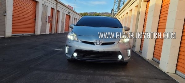

    I ended up wiring a switch to control my DRL's. I need to make a write up on the process but now I have full control of my DRL's.

  11. black_jmyntrn
    black_jmyntrn Senior Member
    Oct 23, 2020
    1,728
    410
    2013 Prius Plug-in
    not when the car is off.
    I just made the diagram cleaner, you can see it on the link below.
    Wiring Diagram for Dual LED Switch Light Bar and DRL -
    andreimontreal and ASRDogman like this.
