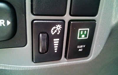

    I appreciate the link to the site but there are 852 On-Off switches alone and NONE of them are stated as being for a Prius. It’s a bit challenging to go through all of them to view the individual dimensions.
    Do you have a group of switch numbers or a model that should work for the Prius (2010 - 2015)?

    Well, that there is what happens when you take the time to post a link to a specific family of products, and then the vendor goes and redesigns their web site so the link no longer goes where it went.
    I think the switches that fit the Gen 3 were these. That link should continue to work until the next time their webdevs feel the need to justify their positions.

    Ok so just to be safe it is the Sequoia 2008 and on switches -

    Seems the perfect Switch D.N.E. for the Prius 2014 I own... Dremmel cutting...here I go
