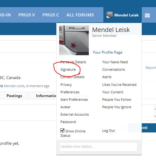

    To add the fuely icon, go the signature page:

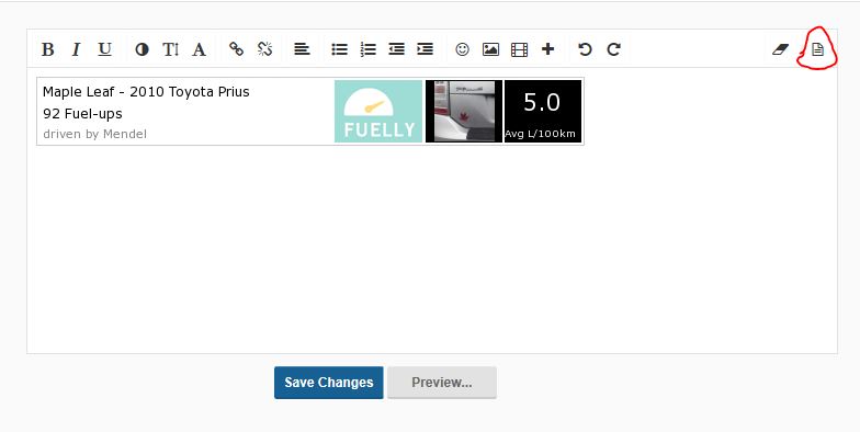

    Then click on the editing button:

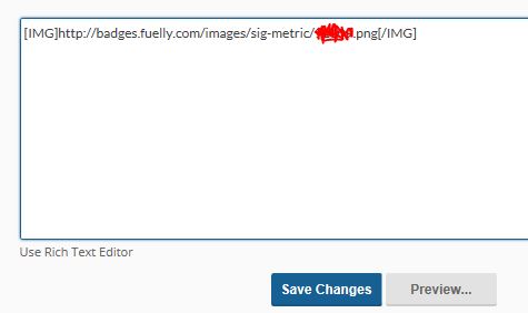

    Get the code from Fuelly, and paste it in. Mine looks like this:

    Click on the car in your garage for which you want share (Eclectic Electric), scroll down the page until you see "Share your MPG" in the right side-bar then click on the "View All Badges and Stuff You Can Share" link. From here you can scroll down until you see the information for the Small Banner. Copy/paste the BBCode from the box to your PriusChat signature.
    hope this helps.
