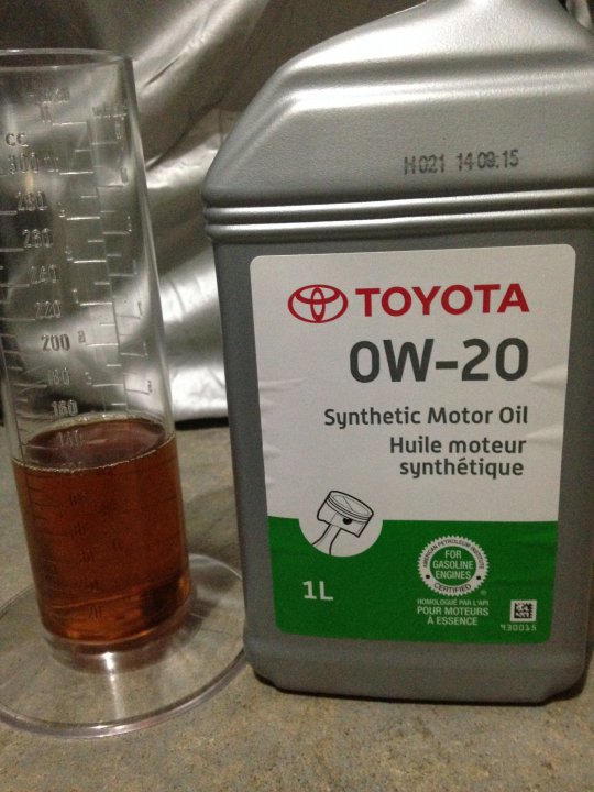

    Toyota 0W20 for example, is darker then some, looks kinda like maple syrup (shameless Canadian plug) when new.

    Easy Rider 2
    Quote:
    The color is about perfect too, and just starting to darken a bit.
    The color of engine oil from one brand to another tells you NOTHING.
    It usually is an additive or two that causes the change in color and not the base oil itself.
    I was comparing the color from when I poured it in to the color of the oil is now. So far several thousand miles on it it has darkened some more. I'll keep an eye on it. It did need a tiny of oil amount the last time I checked it. I added a cup more oil. LOL
