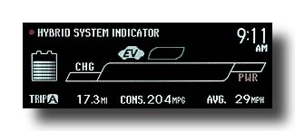

    Since pushing the HV/EV buttons switches the system to hybrid mode, that comment is a contradiction. My guess is you are actually still in EV mode. Are you aware that the engine will run then? When it does, you get a major boost of electricity from the battery rather than the modest amount HV mode would provide. We've coined this EV-BOOST.
    Look at your MPG while cruising on the highway. If it is 50'ish, you're in HV mode. If it is pegged at 100 MPG, you're still in EV mode.
    Notice the symbol differences...
    EV
    EV-BOOST
    HV
