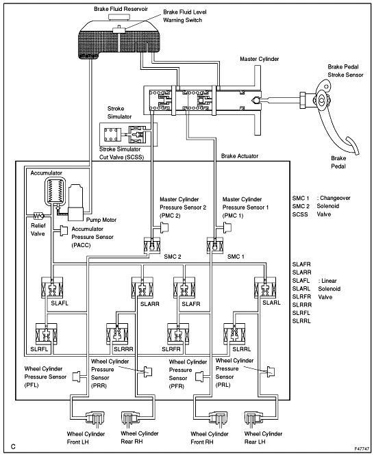

    Excuse my ignorance but do the hydraulic brakes have any power assistance and if so is it electric driven or do they just rely on foot pressure?
    The reason I ask is I was thinking about comparisons with standard cars of the past and realised that the Prius does not have a gearbox, a starter motor, a generator or alternator. By that I mean not as was on my previous car.
  13. Tempus
    Tempus Senior Member
    Feb 17, 2004
    1,690
    Washington DC
    <div class='quotetop'>QUOTE(Orf @ Nov 8 2006, 11:01 PM) [snapback]346055[/snapback]</div>
    The hydraulic brakes are pretty much the same as any other hydraulic brake system. About the only difference I know is that the fluid pressure level in the accumulator is maintained by an electric pump (you can hear it cutting on and off at low speed) instead of vacuum.
