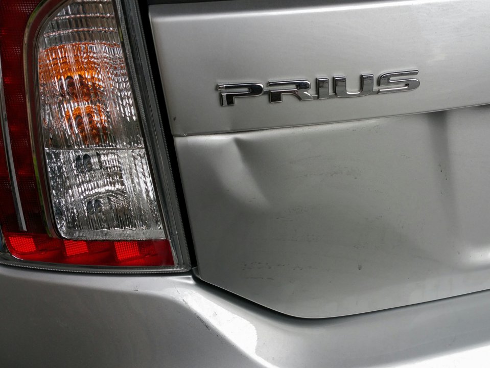

    I screwed up and backed into a RAV's tire and put a small dent in my tail gate door. Does this look it can be pulled or pounded back into shape? And if I need to take the interior paneling off the door how do I do it? I don't see what to unclip.

    it's aluminum and difficult to fix. they had to replace my whole panel and paint it.

    Maybe glue on a little aluminum plate and then a really permanent bumper sticker? Or an emblem of some sort?

    Goodness! I forgot that the Prius rear hatch and bonnet are both made of Aluminium to keep the weight down :)

    Ask a body shop.
    Maybe they can pound it out from the inside, or put rivets on the front, pull it out. The emblem is dinged too. There'll be an hour or so of paint, they'll need to blend.
    Or replace both pieces (per Bisco) and the emblem, and paint.
