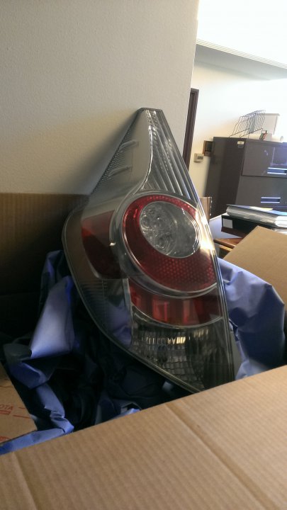

    Hi all,
    A friend of mine has a 2013 or 2014 Prius C (habenero) and I told her I'd switch out the tail light assembly after she hit a mail box. So, i got the attached tail light assembly and am all set to go.
    I was looking for some pictures or a guide, assuming it will be more than just the two bolts. I couldn't easily find one here, but assume someone has done it with all the discussion of aftermarket light assemblies.
    A link or guide or any help would be appreciated!
    Thanks!
    DFL guy

    Future reference for everyone: yeah it was as simple as removing the two bolts and giving it a tug. I continued to use the the original electrical instead of pulling the inside panel off, since it still worked. If you need to replace the electrical, you'll need to pull the inside side panel (a few bolts and screws) to access it.
