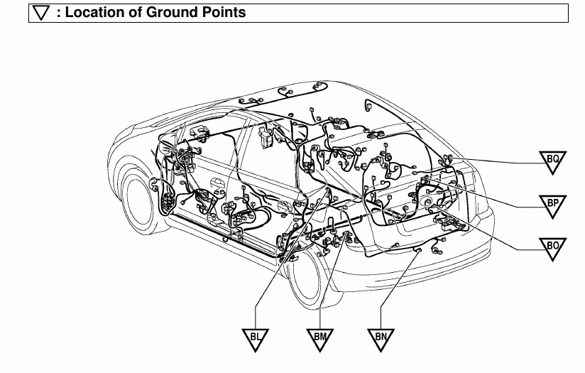

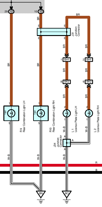

    Before going to replace the lights, I would make sure that the associated chassis common connections are clean and tight. They are located under the rear hatch. You need to take out the rear deck to access the wiring harness.
  10. Abe
    Abe Junior Member
    Jan 5, 2004
    37
    Would you have a diagram, or a link to one?

  12. nh7o
    nh7o Off grid since 1980
    Dec 10, 2011
    1,686
    340
    Hawaii
    Here you go.
  13. Abe
    Abe Junior Member
    Jan 5, 2004
    37
    Much appreciated. Thank you.
