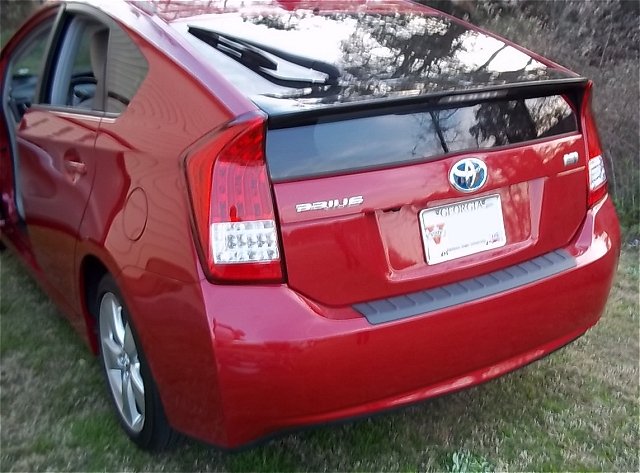

    Hi PC, been a long while.
    I got a set of these (Option Racing Lights - Red) off eBay for a better price, but Returned them because backup and turn signal LED's were useless during daylight. Have yet to find a set that can duplicate light bulb brightness. Wife was behind be going home one day, and asked why I was not using my turn signals. They Looked great though, too bad they did not work. Also when I replaced the rear bumper, there is a space on each side now that I can't seem to git rid of. The whole project was a complete mess and failure. I followed instructions to the letter off the YouTube clip from Valente? , but in the end the original lights just would not pop out. I pulled them straight out like they suggest but they would not move. Stuff got broke to get them out - a first for me. Then to top it all off, there is now grease from the trunk seal everywhere. Arrggh....[​IMG]

    Stick with Valenti or Spec-D taillights. The LEDs are bright enough on these.
    The Spec-D installation video is a bit misleading as it didn't say anything about collapsing the fasteners before pulling them out. Looks like you broke the rear bumper retainer. Just order the part and replace it to eliminate the sagging. If it's not the retainer that you broke, then make sure the overhanging tab at the top of the bumper is actually aligned properly and inserted into the groove.

    Hi 32Kcolors! It's been a while!
    Thanks for the tips! One yellow tab got broke, and a white one popped off into oblivion. The bottom piece split but I fixed that with some krazy glue. I ordered the Valenti HC tail lights from TWP Trade (Their web site said sold out but they had them). As far as alignment goes, I think you are right, I need to reset the seam.
    The Red Prius with Red tail lights looked great! (I had the Option-D lights on there for a day) I will post a pic of the HC'c when installed. The missing reflector on the side: I can cut a piece or red reflective tape and match that on the outside (I have some left over from another project). Someone asked why we wanted red lights since Toyota went with clear and chrome? I suspect that if they came with red already, we could be buying clear and chrome! - Just to be a bit different and personalize our car.
