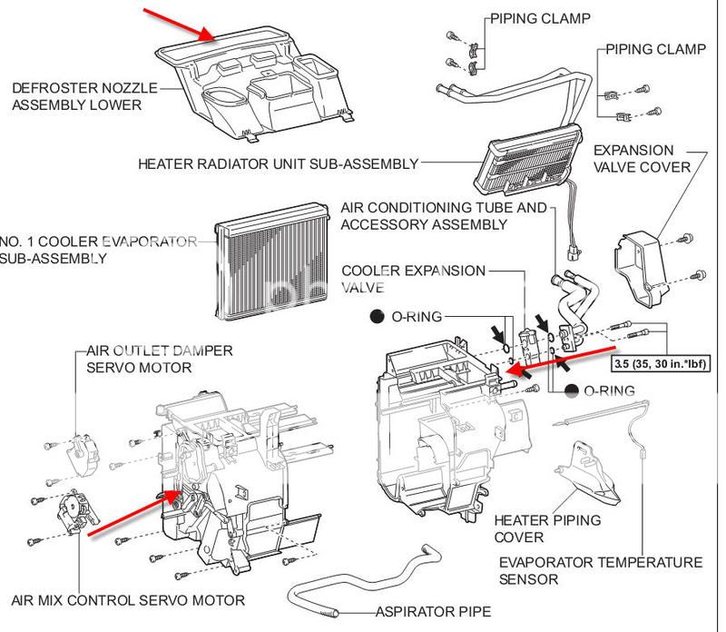

    BTW, has anyone tried shooting the e-coil cleaner/deodorizer through defrost vents or maybe from where blower moror is located? what about under dash on left side of car?
    red arrows represent possible paths that we could use to access the e-coil.
    i do not understand how can we shoot the spray from inside engine compartment next to hi and low pressure lines as those lines do not seem to lead inside e-coil housing but they end at expansion valve? (please refer to idem "air conditioning tube and accessory assembly" )
    maybe we can run a plastic hose through the defrost or front vents right into the e-coil housing and then shoot anti-mold spray?
    it makes more sense to use some other place to gain better access to e-coil than doing it from the firewall side.
    ideally, someone who has a spare e-coil housing can find a safe spot on housing that can be drilled from inside the car?
    or maybe we can use the front vents as access points?
    I am just throwing some ideas here

    I drilled a couple of 1/2 inch holes on the driver side of the case, about 3 inches away from the firewall. I first drilled a pilot hole, and used a fiber optic inspection tool to verify I wouldn't be hitting the e-coil
    I chose 1/2 as this is a common electrical knockout size. So it's easy and cheap to get 1/2 knockout filler plugs at a big-box.
    I don't recommend drilling holes into your case. If you happen to hit the e-coil header or one of the pipes, you're done. This also isn't the perfect solution, as you're not saturating the entire coil. If you're lucky, the disinfectant will work its way into the entire coil
    There is a rubber plug at the firewall where the hi/low lines enter the bulkhead and go into the case. The e-coil is almost directly below. It's much less risky to pop the rubber plug, stick in a tube, and spray/saturate the e-coil.
    I'd recommend a length of tubing with a 90 downward bend, so you can spray directly onto the coil. A common garden sprayer can be used like the kind you use for spraying herbicides and pesticides in your yard.
    Never ever use laundry bleach, it will cause a reaction with the e-coil metals. I've used NuCalgon EvapFresh, which is EPA registered to disinfect e-coils. It's a "no rinse" formula.
    Note: for my FJ Cruiser, the case arrangement is different. I was able to easily drop the blower and force open a blend-air door, and saturate the coil. That immediately cured the smell
    With either my Prius or my FJ, there was no noticeable film or buildup on the e-coil. A lot of this stinky stuff is invisible to the naked eye

    i agree that it is risky drilling holes into evap case.
    BTW, why you do not want to saturate the whole e-coil?
    are you talking about rubber grommet around the AC hoses that go through the firewall? i do not see a rubber plug!
    i see
    good advice, makes perfect sense. you do not want anything that can create chemical reaction.
    it looks like that it may be possible to access e-coil from blower motor/cabin air filter area.

    Toyota has finally issued an official bulletin on this:
    Date: August 6, 2009
    ID Number: T-SB-0261-09
    Title: HVAC Odor
    Service Category: Vehicle Interior
    Section: Heating/Air Conditioning
    Market: USA
    Applicability:
    2007-2010 Camry, Camry HV
    2004-2008 Prius
    Introduction:
    Some Camry, Camry HV, and Prius models may exhibit an intermittent HVAC system odor. A newly designed evaporator sub-assembly has been made available to decrease the potential for HVAC odor.
    Warranty Information:
    This repair is covered under the Toyota Comprehensive Warranty. This warranty is in effect for 36 months or 36,000 miles, whichever comes first, from the vehicle's in-service date.
    Warranty application is limited to occurrence of the specified condition described in this bulletin.
  16. john_dough
