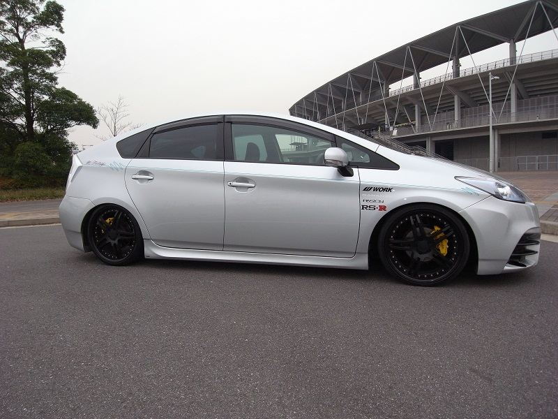

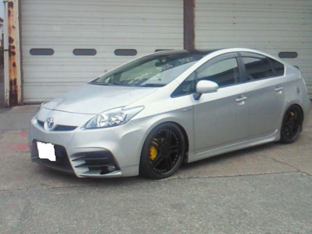

    This front end looks a lot like what SubCode is looking for!
