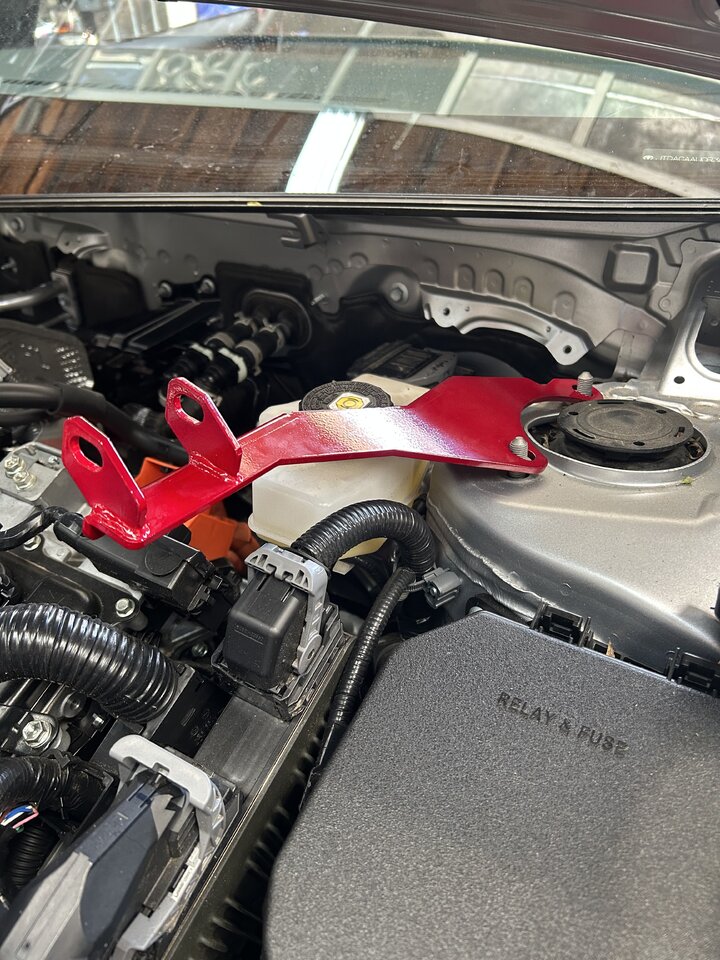

    We got some very bad news! The Tanabe Strut Tower Bar is a ‘no go’ for the LHD Prius in the States. The brake fluid reservoir does not clear the mounting bracket.

    It's more like the bracket doesn't clear the BF reservoir...

    Probably have to go underneath the car

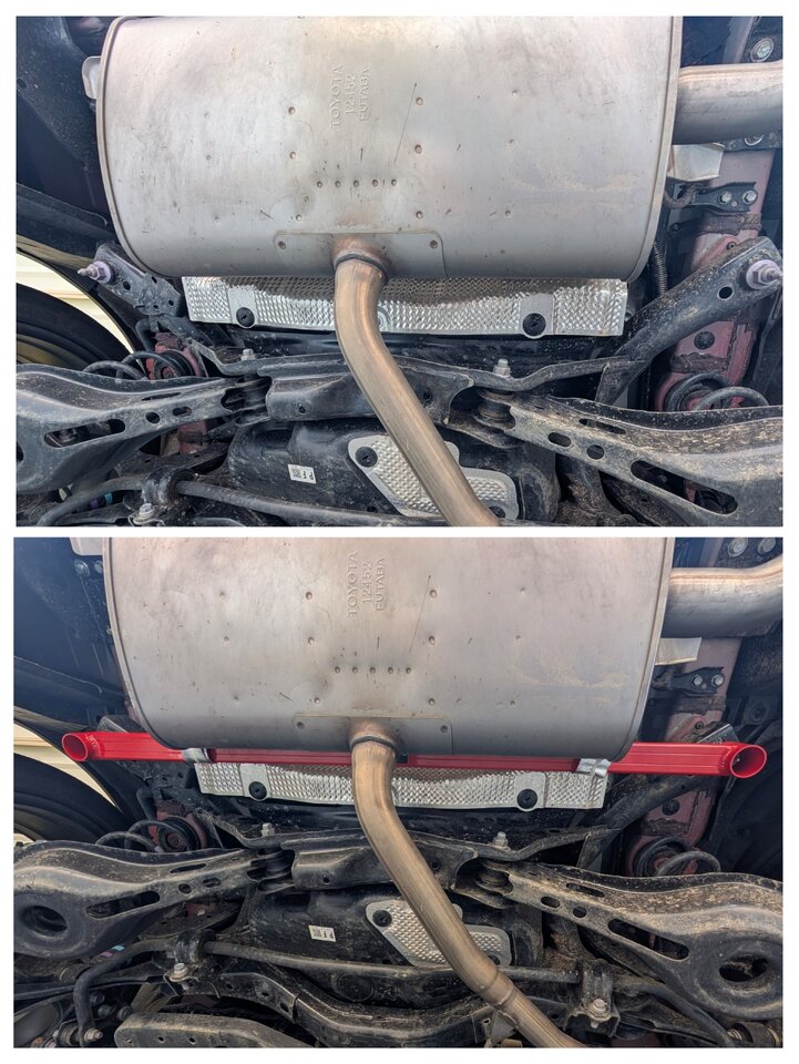

    Ok I got the tanabe under brace for my 24 prime. I can confirm that the muffler makes contact with the brace. Not sure if the prime muffler hangs differently than regular HEV models (most likely).
    I had to add spacers to the muffler hangers and lower the muffler an inch or so to clear the brace.

    Don't know yet. Need more seat time. My goal was to stiffen the rear to make it better while towing (I have a hitch and tow dirt bikes). I'll report back after a while.
