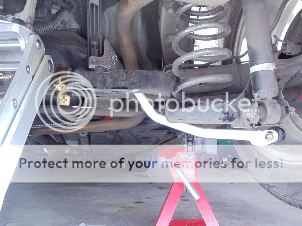

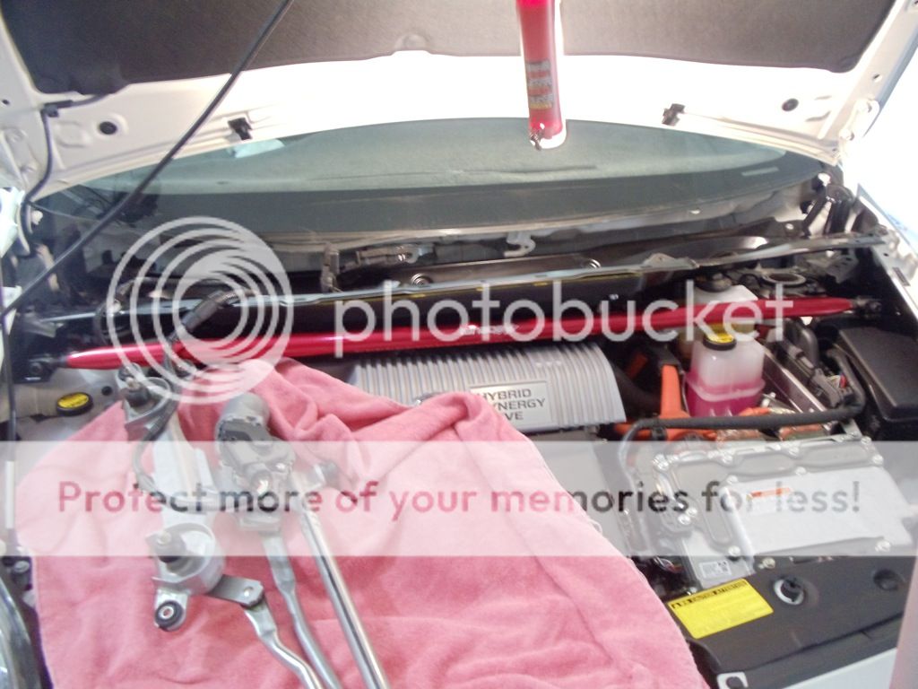

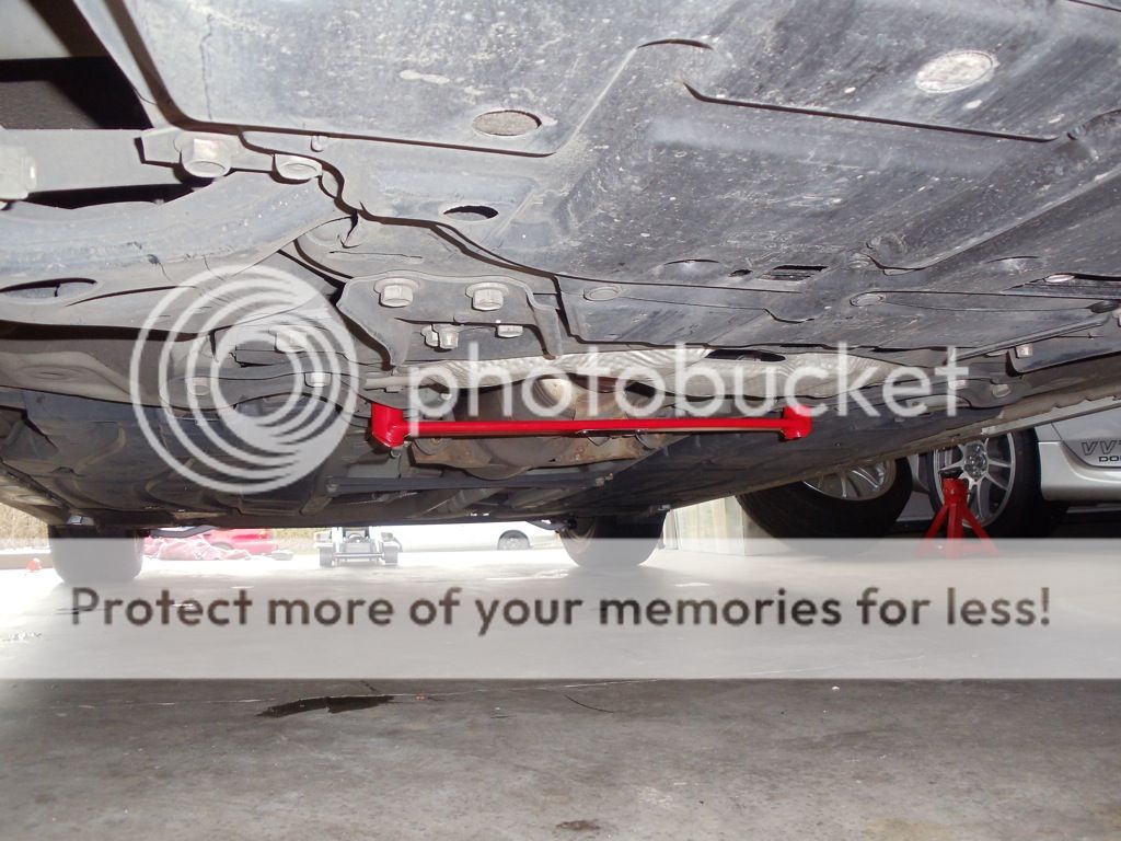

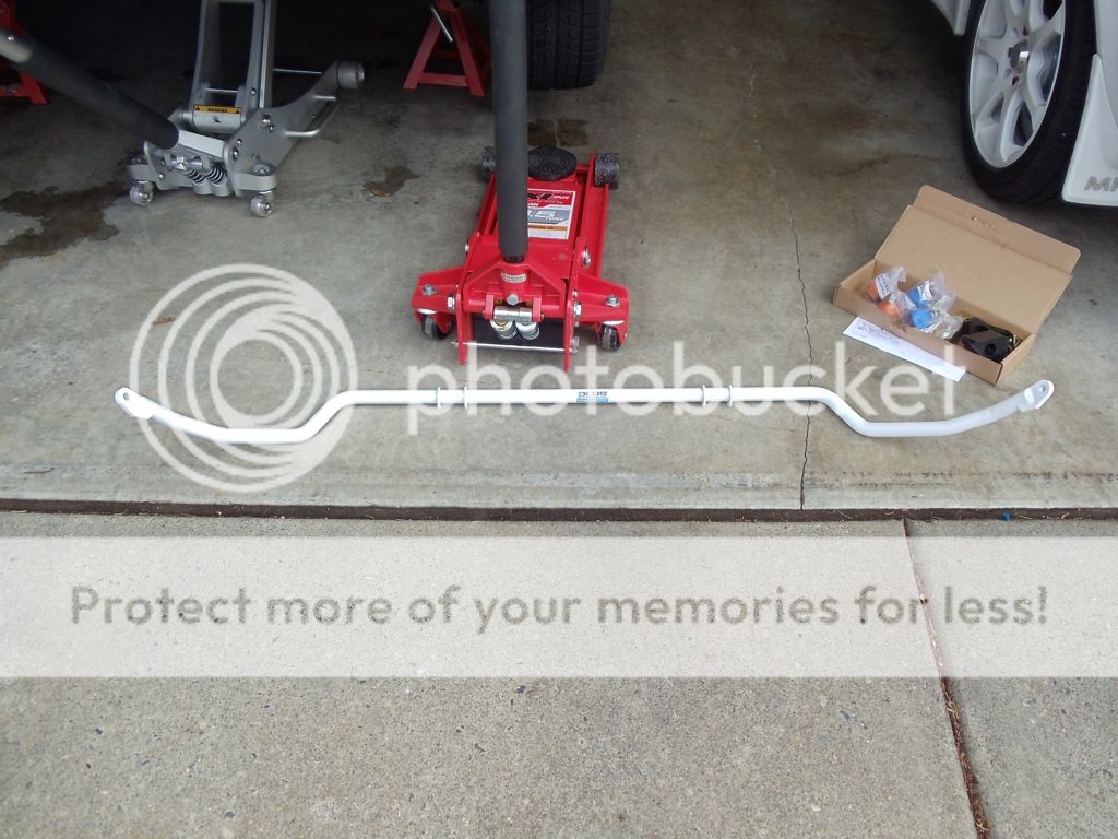

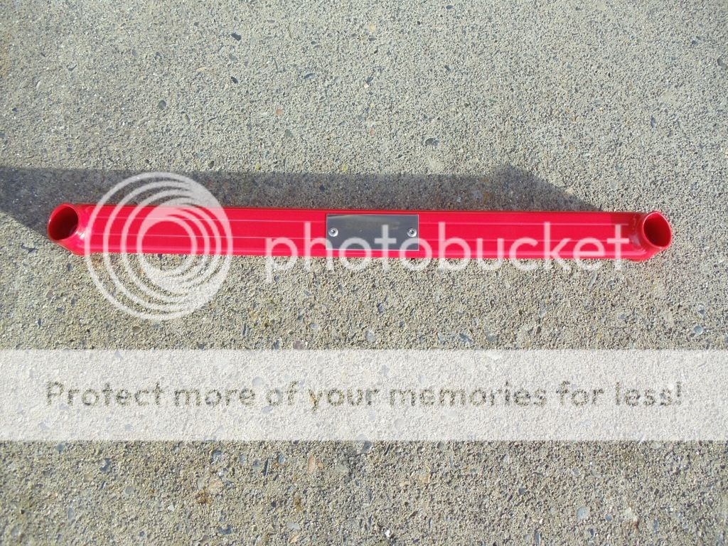

    I finally got around to installing my Tanabe/Sustec front strut brace, lower 2-point chassis brace & TRD/Prius Plus rear sway bar. All 3 were very easy to install & the fit & finish is excellent. Anyone with basic tools can do this with very little time. :D

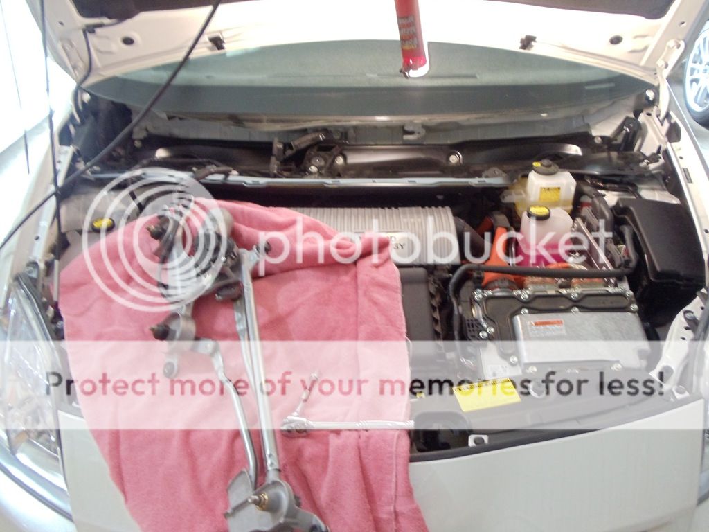

    Cowl & wipers removed......
    Metal tray removed to get to strut top bolts.....

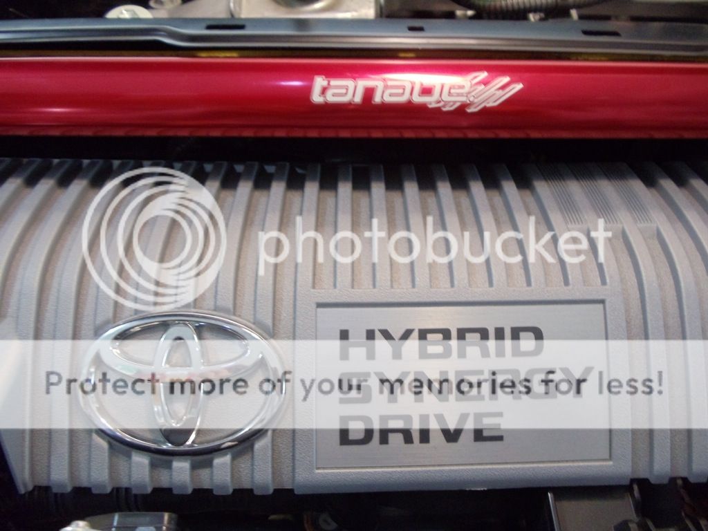

    Strut bar installed......
    After completed install......
    Tanabe/Sustec Lower 2-point Chassis Brace.......
    After installation......

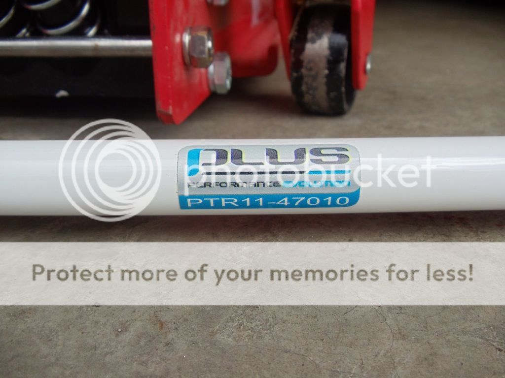

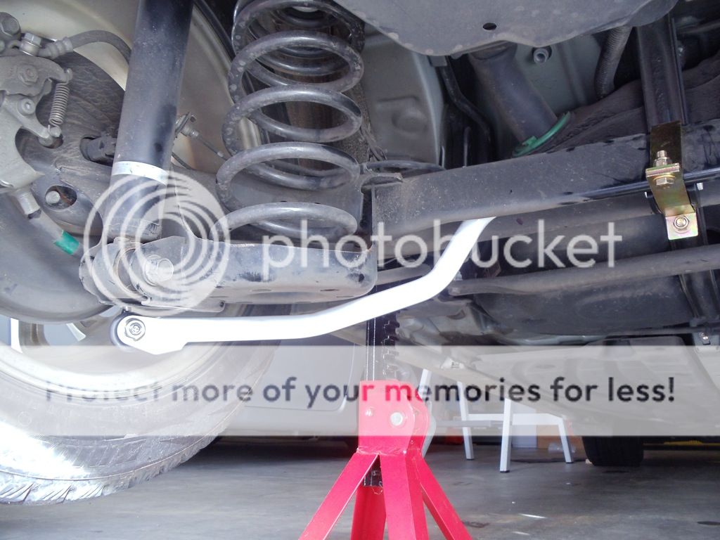

    TRD/Prius Plus Rear Sway Bar.....
    After install......
    Now let the curves begin!!!!! :D

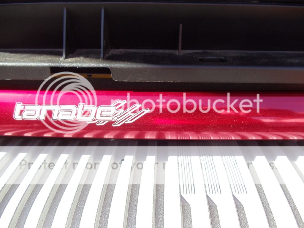

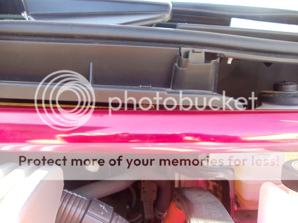

    Can you post a pic of the gap between your wiper tray and the strut tower bar? On the side nearest the brake fluid reservoir, mine is somewhat rubbing no matter what I do. Thanks!
    Also, did you remove the shocks to do the rear sway bar? I did, and found it to make the job a lot easier.

    I'll have to see if I can get a picture of this tomorrow. It doesn't rub anywhere on mine. Maybe if you loosen the 10mm bolts on the metal tray you can shift it back a little bit so it gives you a little more room.
    I just took out the lower shock bolt to shift the shock. The directions from Toyota suggested that it be done that way that came with the RSB. :)

    Awesome, I will get on these as soon as I can. Can you post pictures or instructions on how to remove that plastic cover to get to install the front strut?
  17. Dark_matter_doesn't
    Dark_matter_doesn't Prius Tinkerer
    Aug 8, 2009
    691
    151
    Seattle, WA
  18. SuperchargedMR2
    SuperchargedMR2 Diehard Rams Fan
    Feb 13, 2011
    673
    179
    Vancouver, WA
    It's very simple. Once you take off the wiper blades, the black plastic cover just has a couple of plastic clips & snaps into place. Once that comes off you remove the 4 10mm bolts holing on the wiper motor & slide it out of the way. The metal tray has a bunch of 10mm bolts that allow it to be removed. It's really that simple. About 20-30 minutes doing it the first time but only 10 minutes once you've done it before. :D

    I can't remember, but someone asked me to post close up pics of the front strut brace to see the clearance so here they are. :)
