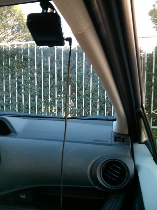

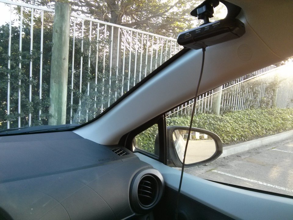

    I don't see any openings alongside the pillar or at the top/side of the glove box. I took these pictures - any chance you'd be able to draw onto them to highlight where I should look?

    well you have to remove the actual cover of the pillar.

    Looking at the picture I run the cable along the seam to the right of the detector, then along the seam next to the window, tuck in along the window dash trim, then under the front console, no air bags involved, easy in out if necessary. As it an illegal device in places, it's stealth.
