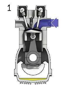

    I suspect this is where we disagree, I do not consider 2 stroke oil as a fuel additive at all. It is not used to supplement the fuel. Two stoke engines use the crankcase to both push the fuel/air mixture into the cylinder as a pump, and to time when the fuel/air mixture arrives (like a valvetrain in a 4 stroke) As such it has no oil pan or oil pump lubricating the crankshaft or cylinder walls, which clearly NEED lubrication. The solution is to add oil to the fuel so it will lubricate the crankshaft and cylinder walls as it is pumped into the cylinder.
    Two-stroke engine - Wikipedia, the free encyclopedia
    A 4 stroke engine, as is almost universally used in cars, has an oil pan and oil pump providing lubrication to the crankshaft and cylinder walls so no additional oil is needed or would even get to the crankcase if it was added. So two stroke oil cannot do it's job in a 4 stroke engine.
