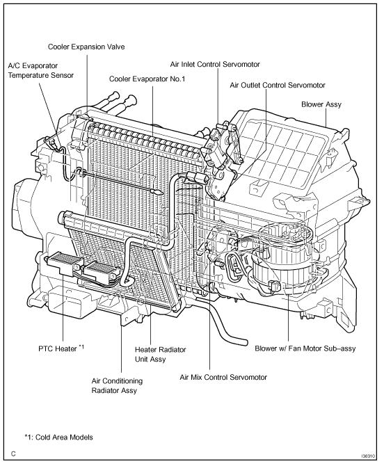

    I'm away on business right now, should be back late next Tuesday. I don't carry that information in my laptop so can't post any service diagrams. However, I did recently sign up with All Data and their service information is almost exactly the same as Toyota's.
    Based on your photos, I believe that plastic shield covers the heater core. The evaporator coil is much closer to the firewall.
    There is a wire on the driver side of the HVAC case that is used to hook up the thermister. The thermister is used to detect the temperature of the e-coil, and the thermister is mounted directly to the e-coil.
    Yes, as I mentioned in the other thread, it's *very* very tight in there. I drilled a 1/8 hole about 1 inch inboard from where the wire enters the case. I then used a fiber optic inspection scope from work to inspect the case area, and determined it was safe to drill the 1/2 hole.
    If you are uncomfortable with this sort of procedure, I would recommend not doing it. Obviously, drilling into the heater core or e-coil is catastrophic.

    Thank you thank thank you!! You saved me alot of trouble. I am so desperate I was going to go back in and take that panel off but I can clearly see by your pic the heater core totally blocks the e-coil. So I'm drilling. I own maybe 6 Dewalt drills all 18 volt so I'm quite comfortable drilling anything. I will patiently await further orders sir.

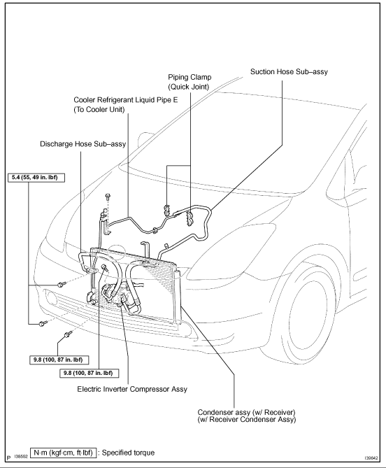

    Anyhoo, I've been thinking about the best way to introduce the appropriate evaporator coil disinfectant directly onto the coil, without the risk of drilling and causing catastrophic damage to the e-coil or heater core
    Today I had one of those "duh" moments and smacked my forehead
    Where the supply and suction lines enter throught the firewall would be a *perfect* place to apply the disinfectant. I don't think Toyota uses pass-through connectors at the firewall, that would raise the cost quite a bit
    I wouldn't be surprised if Toyota didn't use a thick rubber seal of some sort where the lines enter the firewall. It would be fairly easy to cut/remove this seal and apply the disinfectant directly to the coil
    You would still have to be careful how you remove the firewall plug as to not damage the hardlines for the e-coil. But I would think there would be *far* less risk to the e-coil than drilling into the case. Remember, I had borrowed a *very* expensive fiber optic inspection gadget from work, I was able to drill a very small pilot hole and snoop around before drilling the big hole
    You would still have to fashion a chunk of brass tubing with a 45 degree or 90 degree bend in it to spray DOWN onto the coil. If possible, I would still try to see if there are any large industrial/commercial shops willing to rent the fiber optic scope, to verify this
    But you can see why this would be a much easier job? To plug to resulting hole in the firewall, if you haven't destroyed the seal/plug, you could just reuse it. Or glop on some silicone.
    I would strongly recommend you check out the firewall area for this procedure. The engine may provide a bit of clearance issues, you may have to swing the relay box out of the way. I also believe forum member Hobbit has detailed instructions at his web site on how to remove the cowl assembly - he came up with a method *far* easier than the shop manual - to make access to the suction/supply lines at the firewall bulkhead
    Facing the engine and firewall, the heater core hoses should enter the firewall on your left, near the passenger side area. The A/C lines should enter near the middle of the firewall. The A/C lines should be wrapped in a foam pipe wrap sort of stuff.
    I logged onto All Data and grabbed another photo of just the A/C line locations. Hope this helps. In the meantime, my mouth is watering at the thought of heavy drinking. I'm also upset I'm missing our Victoria Day long weekend.

    I took a look at my 2004 when getting gas today. If you first remove the cowl, you will have excellent access to the rubber seal where the A/C pipes run through the firewall. Hopefully an access hole drilled into the center of the rubber seal would allow you to dispense the disinfectant on top of the evaporator coil as Jay suggested, without risking damage.
