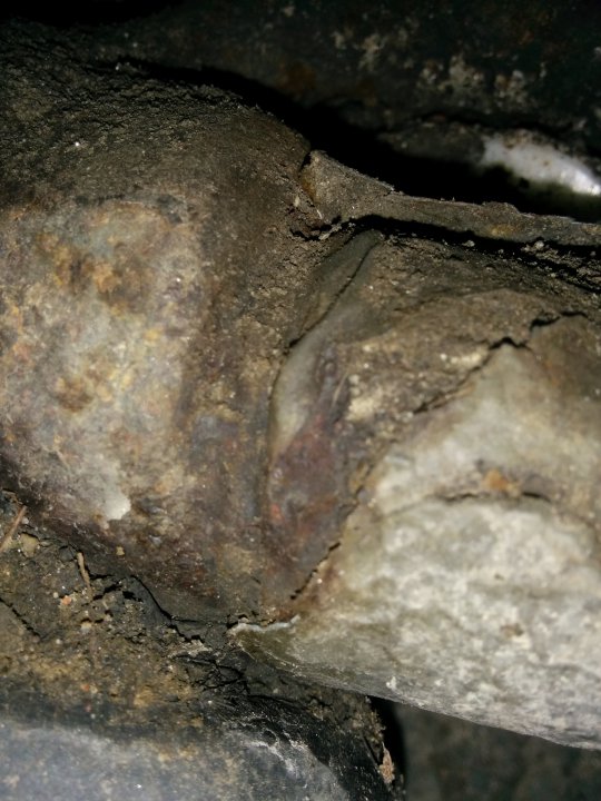

    That's great! I'm glad this helped someone. Given how similar our problems are, I'd like to see if I can rule this out. Would you mind sending some of the pictures to me? I've looked at the pipe on my own car a few times already and didn't see anything, but maybe I'm looking in the wrong place.

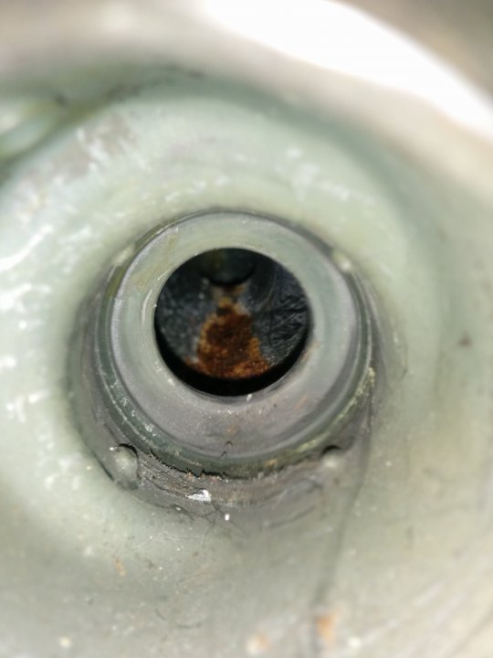

    Hopefully these come through. I'd say if there is any hole water could enter, given that the pipe is fully exposed in the wheel well. You can see in the first picture the corrosion on the inside of the pipe from water getting in.

    And wrt Patrick's point - it appears to be relatively easy to replace the pipe. Don't need to drop the tank or disconnect much. I'm going to see if I can source a replacement pipe, but am confident the rubber repair will be effective for a while. I used rubber rather than metal tape because a) I don't think fuel will come in contact with the repair, because it's on the top just inside the nozzle seal, and b) it's right where the pipe tapers and I needed a flexible tape to cover the taper. The second picture shows that - I cleaned it up and wrapped that area.

    Ha! Jeff, you're a genius! I hadn't been able to find the hole until last night. It doesn't look like there is a hole there when you look at it straight on, so I'm not surprised the latest mechanic didn't see it just looking around. I decided to take advantage of the dark and stuck a flashlight under the wheel well and peered down the pipe. What do you know: a spiderweb of holes just near the opening. Nothing would leak out when fueling up because the nozzle goes past them, but when I poured a little HEET in to test and looked underneath, it was coming down like rain.

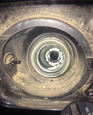

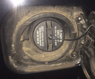

    I am very interested in what caused the 'spiderweb of holes.' If or when the pipe is replaced, it would be helpful if it could be analyzed to identify the root cause. You are in a salted-road area so corrosion is likely.
    Pictures would also help so we can check our own. I'm headed out with a flash-light and camera.
    • The accumulated road 'dust' is there - will use a vacuum hose and brush to clean it out with the cap on.
    • When I take the cap off, I get a strong wiff of gasoline fumes suggesting a slightly higher pressure.
    • The rubber ring on the outside looks OK - can you see any evidence of water leaking inside the trunk following the filler tube?
