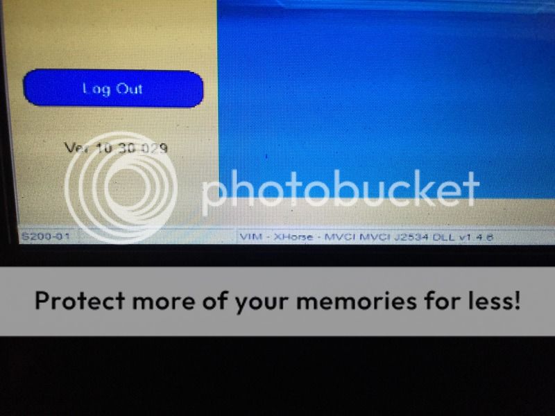

    Oh don't worry Don, like I wrote, disable the wifi
    You should see this when you open the TIS program and MiniVCI plugged in:
    There should be only 7 blue buttons, if you have more you are not using the standalone TIS program
    Now look at the left lower corner, you should see "XHORSE" if not, you need to load the proper MiniVCI driver
    johnjamis likes this.

  18. DRACO
    DRACO Member
    Nov 28, 2015
    362
    78
    Rancho Palos Verdes, California
    2002 Prius
    Good Job Crain,
    Get some rest :)
    Make sure when you connect the MiniVCI, it reads XHORSE on the bottom left like pictured above. If so you are good to go.
