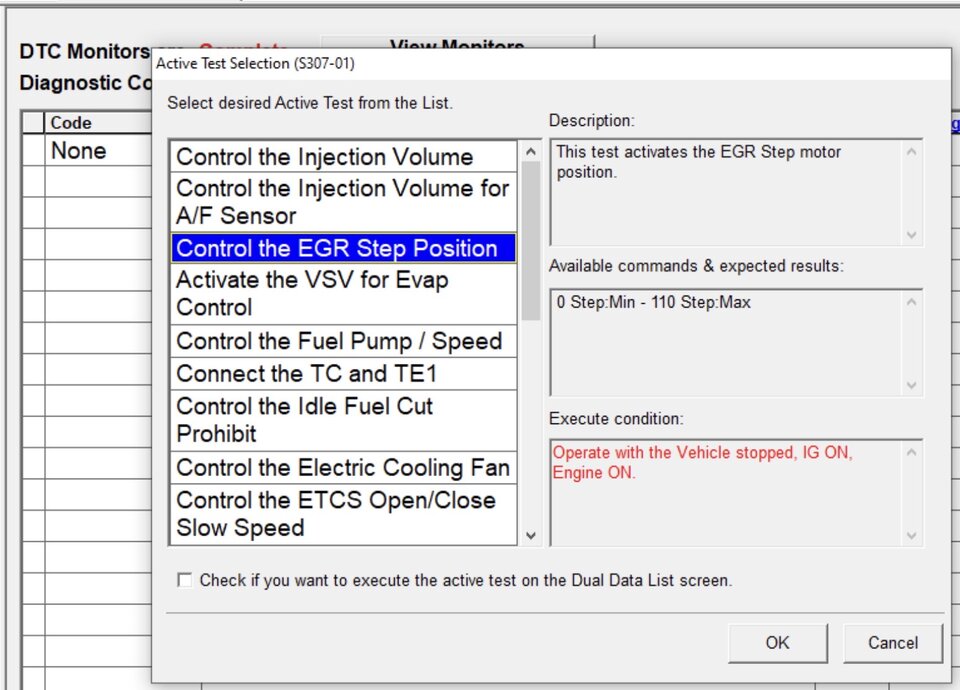

    @RWD Any initial test is to physically block the EGR passage and analyze effects.
    The professional TCCN video linked by @rjparker shows this.
    Also - as you have techstream - you can force close this valve via the EGR active test with engine running….
    Step 0 is closed valve.
    If
    the EGR valve is clogged, physical block analysis - compared to the effects of step zero - with reveal this issue.
    #349 priumium, Jan 8, 2026

    For anyone about to use that EGR step active test, it's good to take a look in the repair manual for some things Toyota wants you to be careful about, some collected in this post in 2019.
    Generally, when you'd be doing such a test, the engine will be idling; its target EGR step at idle is zero anyway. In the places where the repair manual suggests using the active test, it is generally having you override the normal zero target with a higher step, to see what happens then (and then leave it the way you found it by setting back to zero).
    Any time the target step is zero already, setting it to zero with the active test doesn't do anything more to force the valve closed ... if the ECM targeting step zero hasn't closed it already, it's not like you get a more forceful step zero by requesting it in the test.

    Correct. Any reasonable and objective person seeking priuschat instructions and help, would likely understand this? The EGR valve step test are made our of steps. Apx 120 steps for this motor.
    Why don’t you link this EGR active test manual excerpt, if there is such a chance of misunderstanding?
    Your helpful input could make it obvious how to use TS active tests...
    Do you work for Toyota perhaps? That would explain a lot… ;P

    Copyright infringement?
    Anyway, never really looked through this personally, but this is maybe it:

    Step 110 is fully open, according to the post from 2019 that I linked to above.
    The post from 2019 that I linked to above includes a short rundown of the points from the repair manual, and also how to find the full procedure in the repair manual:
    The P0401 excerpt that Mendel posted is another of the multiple places in the manual where the same instructions appear.
