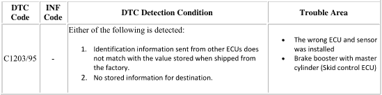

    That's kind of a loose take on what C1203 means. What the code means is this:
    which is to say, it can communicate with other ECUs in the car, but it doesn't like what it is hearing from them. You can get the code, for example, if you install a brake actuator/skid ECU, built for one destination market, into a car where some other ECUs are reporting a different destination market. The manual suggests it compares its own notes with the power management control ECU's, the main body ECU's, and the yaw/acceleration sensor's.
    So that can be a headache if that happens, because it would mean going out again and buying a part that matches the car this time.
    But there is also this:
    and indeed, we've seen plenty of that on PriusChat, where it's scary to see that code but then somebody gets through the linear solenoid learning routine and it goes away.
