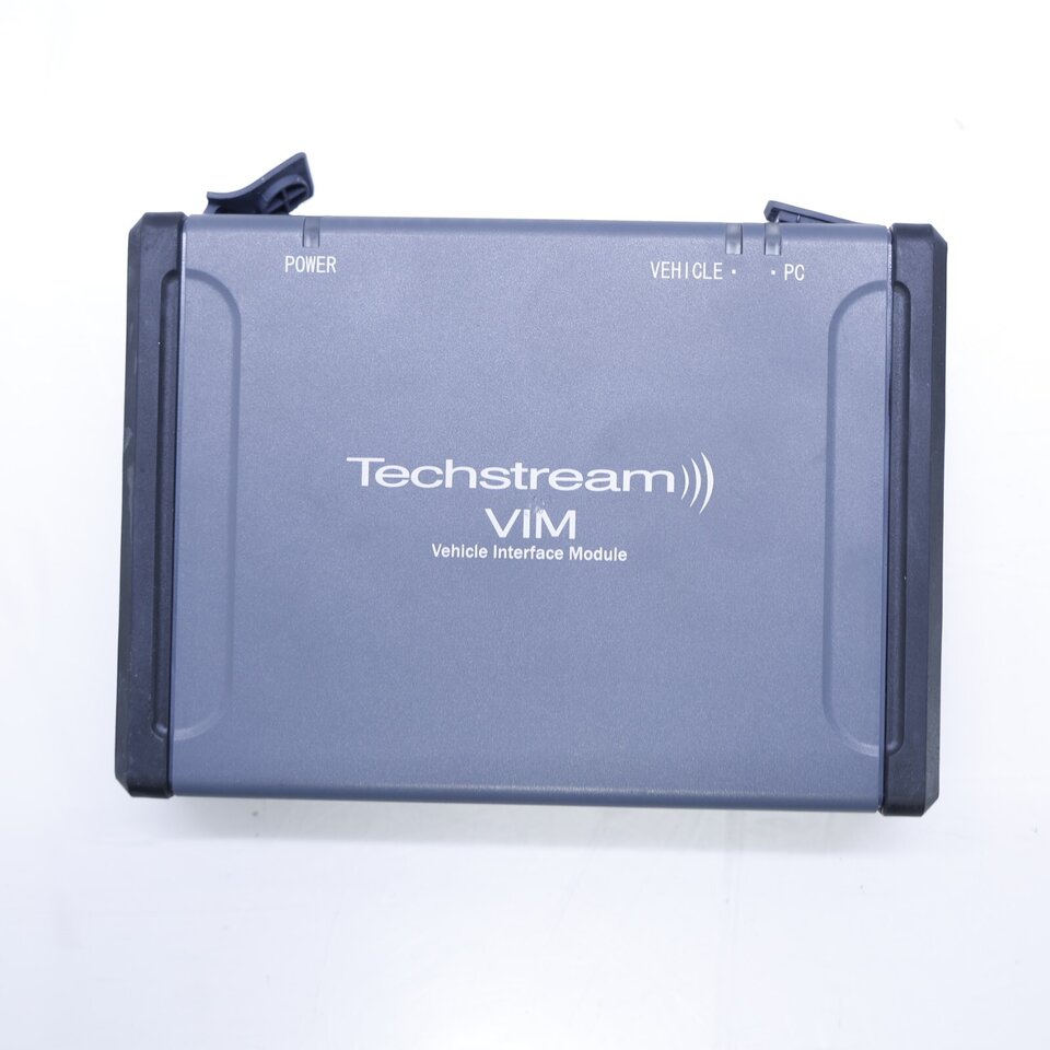

    I currently use Techstream with an Amazon J2534 VIM connector and works fine. However, I recently saw a TECHSTREAM DENSO INTERFACE VIM module for sale online for $300 and wondering a few things to see if it's worth the switch or simply stay with my current setup.
    1. Are there any advantages to using this larger VIM with any version of OFFLINE Techstream ? (I currently have access to v18).
    2. Are you able to do things with more things using the TS VIM vs the J2534? Does it require specific drivers and are they readily available online for download or proprietary to Toyota.
    3. I see the TS VIM has a port labeled “Power”, so does this have to be connected to a wall outlet for use or is it only to charge the unit?
    4. Lastly, the one being sold has the unit and only includes the USB connector from the VIM to the laptop. Is that enough or as I was asking in # 3, do I need a power cable and if so is it hard to get or can I get around an aftermarket one?

    The Techstream for home users is basically just that, enough power for a home user. May not be as robust or reliable as the dealership version with a better cable connection. Since you have a gen 2 car, you probably can do every function with your current techstream that allows for a gen 2. So upgrading is just a waste of money, unless you're looking for more reliability. If that's the case, you should invest in a better cable that's probably going to cost you $300 or more

    I no longer own a Gen 2, I have a Gen 3 but I would want it to work on either gen obviously since I sometimes work on other people’s cars. So, basically no additional functions for the offline version using this specific dealer VIM? I had read somewhere that you could not program keys, TPMS or ECU’s with the Amazon cheaper scanner and needed a higher end cable like you say but this is apparently that since its what they use at the dealership (not sure if currently).

    That VIM module was used with a very old (obsolete) version of Techstream. The J2534 interface cable is the replacement used for newer versions of Techstream. So the VIM you show the picture of in post #1 will not work with version 18 of Techstream that you are using.
    EDIT: FYI, the J2534 cable that Toyota recommends for the newer versions of Techstream was a Mongoose cable made by Drew Technologies. It cost about $600 new

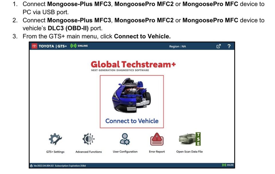

    No interface with the v18 or older Techstream will program ecus anymore since Toyota has a new graphical GTS+ version that has to have a subscription. Recent vehicles (~5 years) need it for keys as well. TPMS id writes are still functional on the old Techstream in offline mode.
    New GTS+ Tech stream
