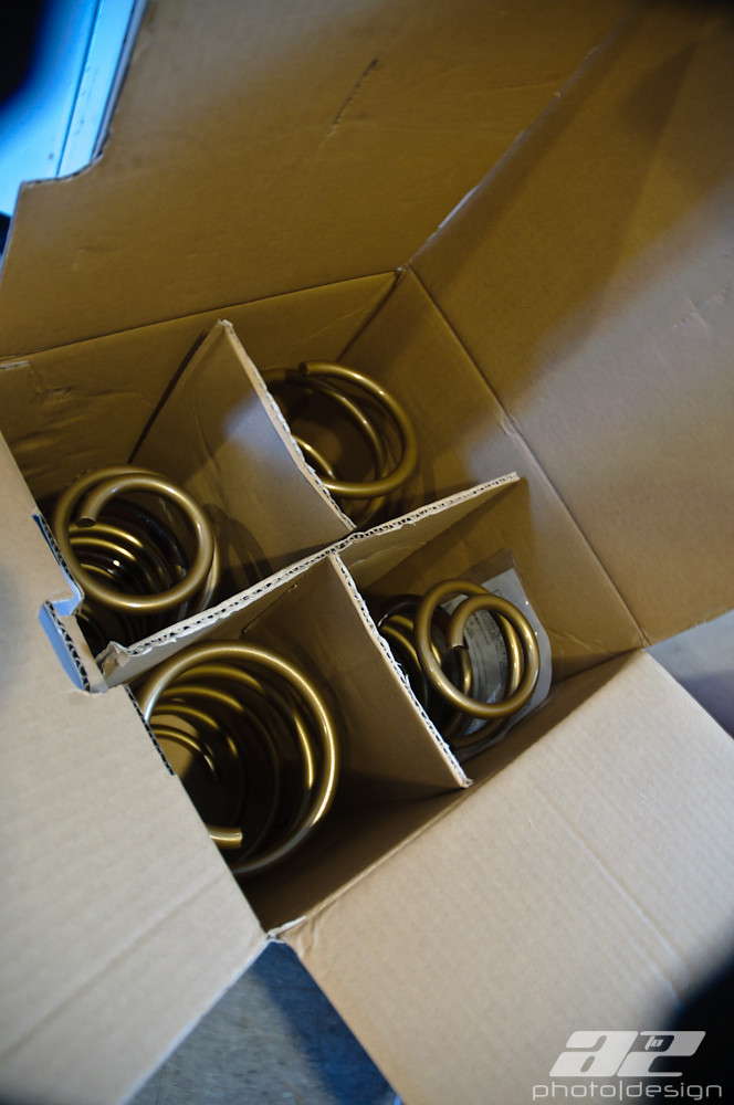

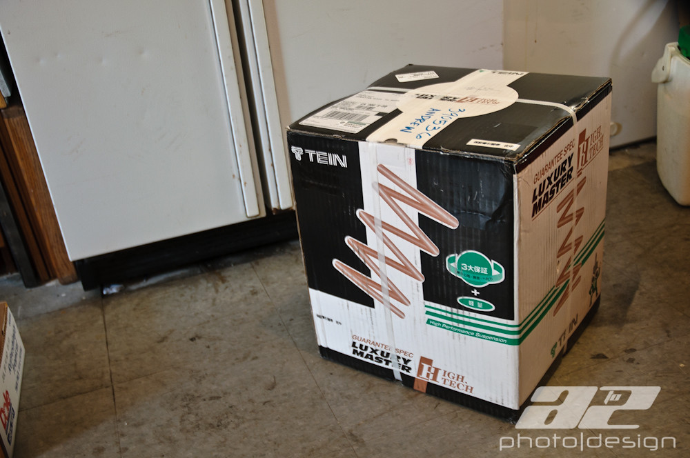

    UPS delivered these bad boy yesterday hehe. I'll be installing them tomorrow ^_^

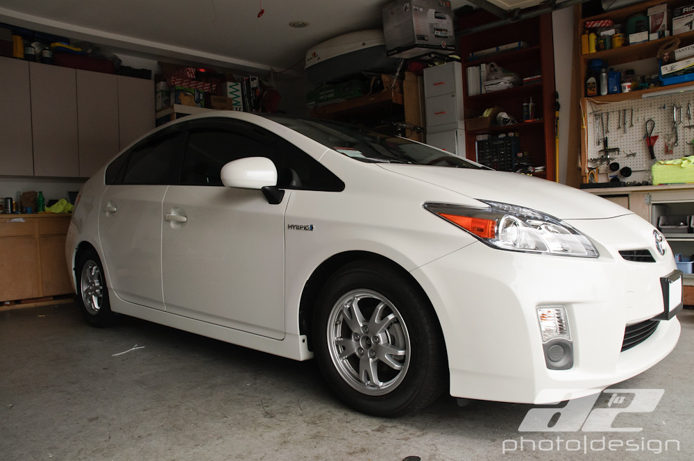

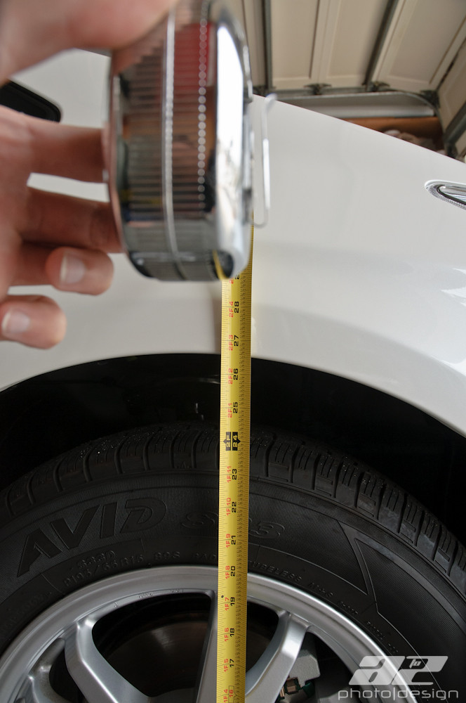

    Well I installed these bad boys yesterday and everything was going smooth until I was up front and realized I had to take the whole wiper assembly and tray off. Luckily that only took 30 mins to do and I was able to finish the whole install in ~2 hours. I'll be posting pics and a DIY guide later tonight. I have to get my camera out of my car still.
  18. andino
    andino Senior Member
    Jul 15, 2009
    746
    550
    San Jose, CA

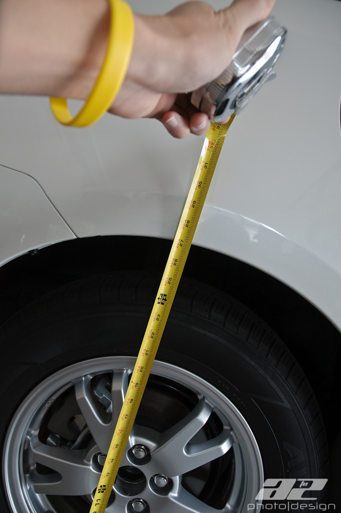

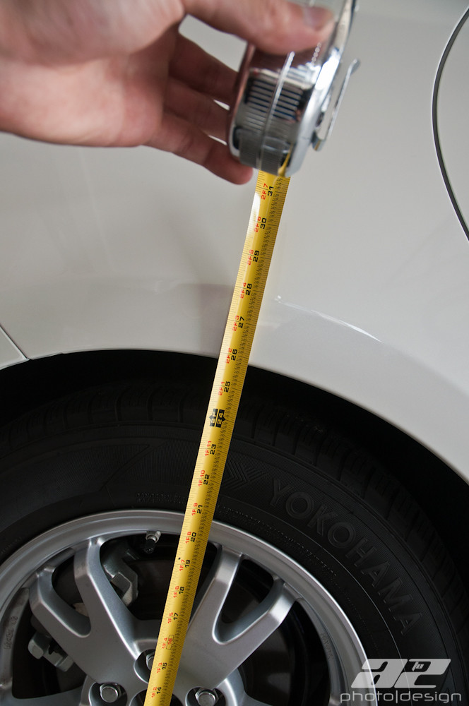

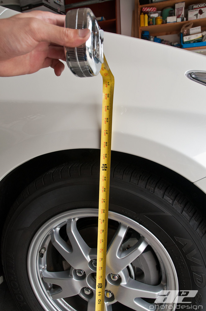

    Sorry for the delay. Didn't get a chance to upload the photos from my camera until today.
    Here's a rough measure of the front and rear prior to installing the springs.
    Front:
    Rear:
    Post install before settling:
    Front:
    Rear:
    Full car shot:
    Edit: Sorry if the images are messed up. For some reason, the site (or my computer) renders the portrait shots as landscape.

    ^^ Haha yeah it took longer than expected. I tried to be as detailed as possible.
    5 day report after install. Ride is pretty good. Close to OEM with a bit more harshness over bumps; though that's to be expected as it is lower. Seems to have settled at ~2 finger gap all round with OEM wheels. I think my pressures are a bit low since I'm getting kinda crappy mileage but it is hotter. Feel wise, the car doesn't feel all that much more stable but it is a bit more reassuring if you hit the turns quickly. Stock tires are pretty crappy for grip and braking so that probably has a big part in the sloppy feeling the car has. I'm hoping to get some Scion tC 17s from a friend soon or I'll be ordering some wheels myself.
