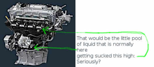

    I think at least a couple different stories have been glommed together there, which is why you're having trouble finding 'the' explanation.
    As for the coffee-colored wet sludge beneath the throttle body, you find that in every Prius ever driven, starting with the first generation in 2001. The first two generations did not have EGR systems*, but still got the coffee sludge. I don't think anyone is seriously trying to pin the coffee sludge on the EGR.
    The intake valves close well after bottom dead center, when the piston is moving back up on the compression stroke, and that's what gives the engine its Atkinson-cycle characteristics. That pushes some fuel-laden charge back into the manifold. The glop down there may be a mix of that fuel, and some moisture, and some oil that may arrive through the PCV system.
    Some people worry about the small puddle of glop at the bottom of the manifold, or add oil catch cans hoping to reduce it. One thing I can say, show me anybody who has driven a Prius for n00,000 miles, and I'll show you someone who drove it for n00,000 miles with a small puddle of glop in the manifold.
    There have been a few posts where somebody thought enough of that glop could be slurped into the cylinder to cause a problem. In one of those threads, I posted a simple cross-section of the engine showing the shape of the manifold and how high the glop would have to get slurped. I'm having trouble finding that thread now and don't feel like drawing the picture again.**
    The completely different story that gets mixed in with that is the story of how hydrolock, with incompressible fluid in the cylinder, can lead to dramatic engine failure. That really happens. The incompressible fluid is usually coolant, and it gets there through a head gasket that already has failed. So that story has three chapters: chapter one where the head gasket fails for some reason, chapter two where there are some rough engine start-ups because small amounts of coolant have leaked in while it was stopped, not enough to cause hydrolock but enough to cause a rough start, and chapter three where enough coolant has leaked in to stop the piston dead before TDC, and some other part of the engine goes out through the block.
    Note that's a whole different story from anything about the glop under the throttle body.
    As for chapter one, what caused the head gasket to fail in the first place, nobody has clearly shown a single culprit. There are some members (or one very convinced member, anyway) convinced it has something to do with EGR. There've been other suggestions about too-infrequent coolant changes, where the coolant's anticorrosion additives get depleted, and the coolant eats away at the gasket sealing surfaces. Others have speculated about the extra thermal cycling seen by an engine in hybrid service.
    So chapter one doesn't have a very clear cause identified. The parts of the story that we do know are, as soon as chapter one happens (for whatever reason), we know why chapters two (and three, if it's not fixed in time) will follow.
    * All Prius generations have variable intake valve timing and, on the advance side, it can open the intakes while the piston is still moving upward on the exhaust stroke ... up to 18° before the top of the stroke (for gen 1 and gen 2, I don't have the gen 3 or 4 figure handy***). That's been referred to as a form of "internal EGR", but it can't be very significant; cos(18°) is more than 0.95, so there's no more than 5% of the exhaust stroke volume left at that point, and the exhaust valves are still open too, so it's not like it's all going to go in the intake, plus the exhaust was initially under high pressure, so much more than 95% of it has already gone explosively out the exhaust valves by that point. Also, under the operating conditions where maximum valve advance is used, it may be that the tuned resonance of the intake is pressurizing the intake charge at that point, so the brief overlap of intake and exhaust valves both open may have more of an effect of scavenging the last of the exhaust out of the cylinder with inflow from the intake, than of backing exhaust into the intake.
    ** Ok, it came up in another thread today. I'm still not finding that older thread or the picture I drew then, so I went and drew it again anyway. The old one was a better, cross-section diagram, but this gives the idea:
    *** Oh, look, I do have it, it's 29° for Gen 3.

  15. ChapmanF
    28,721
    19,020
    That's my take on it. There's usually a little pool down there at the bottom of the manifold, minding its own business, and that's just how a Prius is.
    It's made out of volatile stuff, so sometimes some of the stuff evaporates and gets sucked in with the air and harmlessly burned. And some other volatile stuff maybe comes back out and condenses into liquid in that little pool, so it stays there and minds its own business.
    The manifold is tall enough that whenever I see talk about that little pool getting slurped into a cylinder as liquid and and causing any problem, my reaction is a resounding "o_O".
