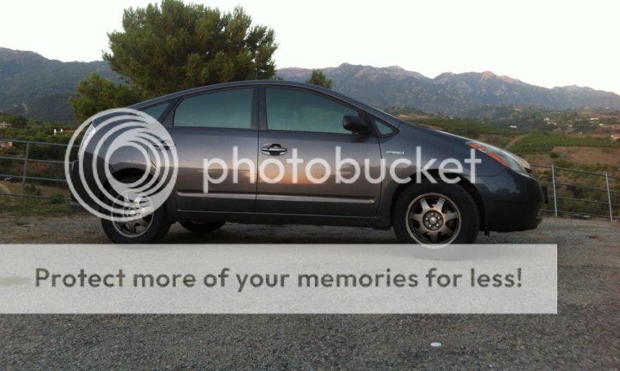

    I had to delete some pics and re-upload lower resolution images..
    https://i159.photobucket.com/albums/t160/oliver43/liftedPRIUS_1.jpg

    Yea, I hadn't used photobucket in awhile and since posting some pics here recently I learned.. I forgot to shrink the file size down and Iv exceeded their 'bandwidth' and now they want money from me.. Im sorry y'all... I'll look for new way.
