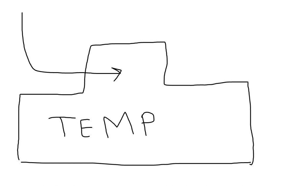

    Suddenly today, a symbol started flashing intermittently in white color on the car's dashboard which I couldn't find in the manual. It showed up on the dashboard which is next to the speedometer (where time is shown).
    It looks like a Car with an arrow coming inside it and word TEMP written on it (see attached picture of what I can recall)
    Any idea what this could be?

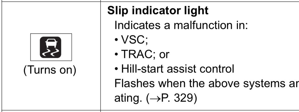

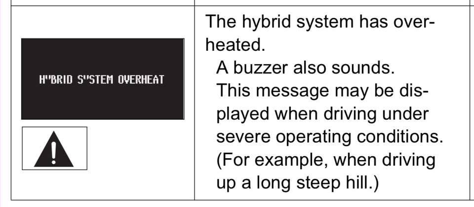

    Temperature warnings should not be ignored but there are different sources such as engine, hybrid system and battery.

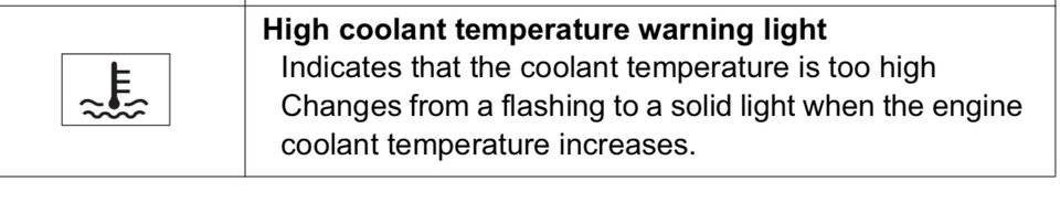

    Most of us don't have an early plugin but the engine cooling warning looks like this:

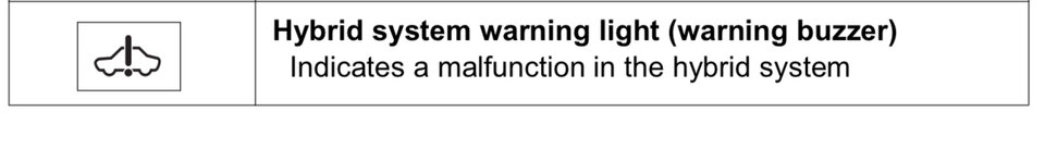

    A Plugin Hybrid System (usually inverter) Warning
    A Prius v wagon has this "car" for hybrid system warning

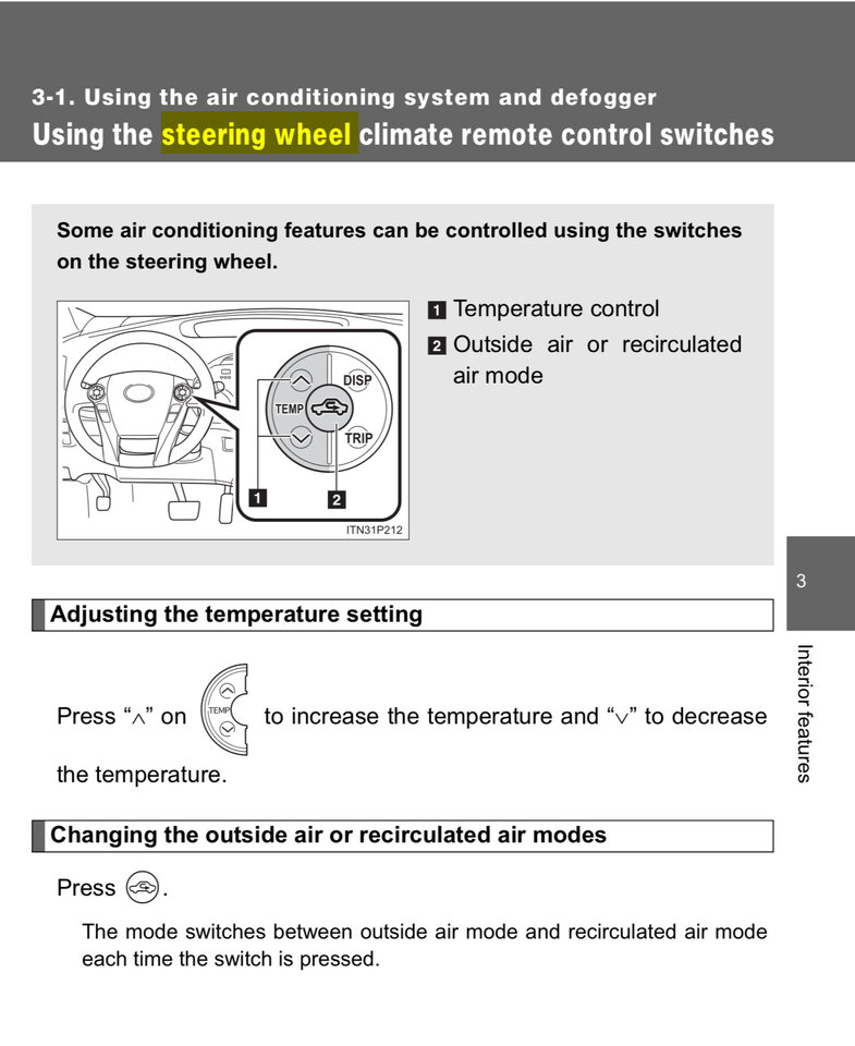

    Attached is a section of the 2012 Plugin manual explaining warnings

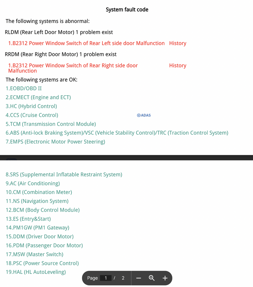

    Approximate warning sign image that came up in white color is attached.
    Also attached is the scan report I got. I don't know why RLDM and RRDM came as red, they both work well.

    i suspect that scanner isn't adequate for prius

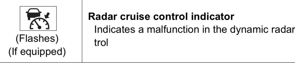

    It almost has be a message on the multi function display that was misread or was added with some ecu update after the manual was released or it was a car symbol meaning something else like

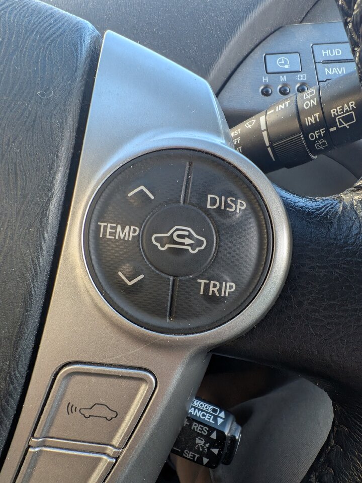

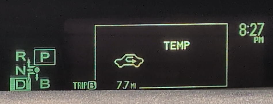

    I solved the mystery.
    It was a button on the steering wheel which I was pressing accidentally & unknowingly. The reason this symbol wasn't found in any warning signs manual because it's not a warning sign
    However this made me change all the important fluids. My hybrid transaxle fluid was practically black in color.
    Car is back to normal. Thank you everyone for the quick help!

    The good ol ac temperature control

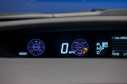

  18. ChapmanF
    28,721
    19,020
    Funny, my 2010 has the "Touch Tracer" mimics that show up next to the speed, but I don't think it shows that status display on the MID. If you press the button, does it show your temp setting? I would like that better than having to look down at the climate display.
  19. priumium
    priumium Member
    Sep 8, 2024
    335
    81
    Sweden
    2013 Prius Plug-in
    On PIP1 (and facelift?) it indeed shows the temperature set value on the MID. The steering wheel buttons are also moved around in PIP or since facelift. I was not aware.
