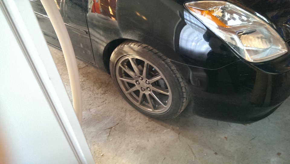

    Do you have any pictures of the car on its 17s? I don't think I've seen one come off the lot with 17s.

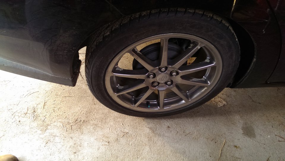

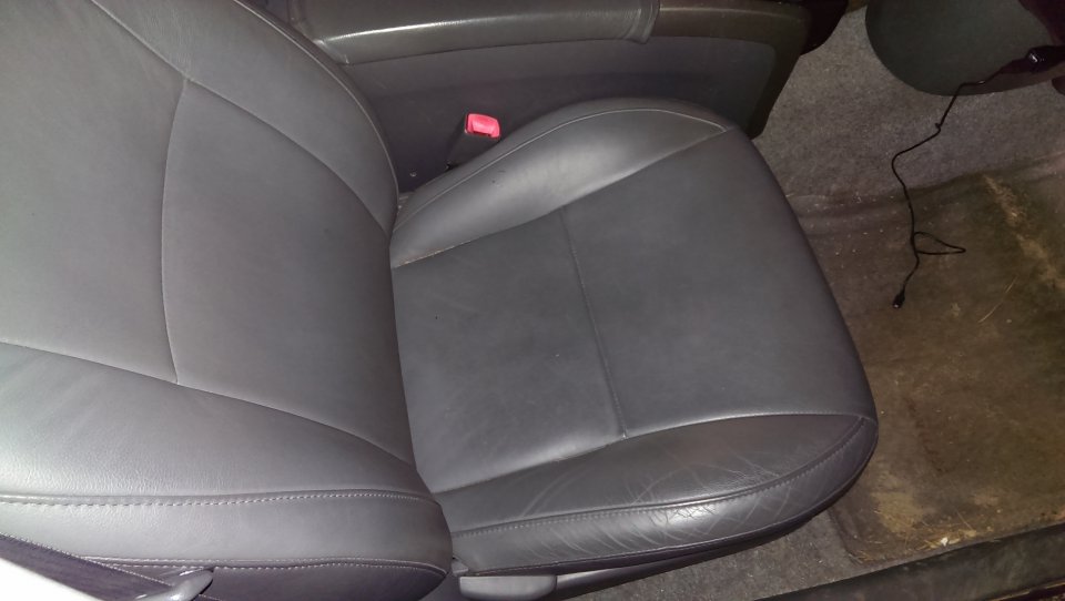

    Here you go...
    My car also had leather seats which wasn't offered by Toyota factory in 2005. However, when you buy a Toyota in the Southeast they all go through a Toyota distributor who actually changes the standard options packages available. The wheels, tinting and a pinstripe were dealer add-ons that were not optional if you wanted a Prius back then at any of the dealers in SE Florida.
    Here's some pictures of the wheels and seats. Sorry, they're not great snapped them with my phone while it was in the garage. The winter here has also made my poor car filthier than it ever was down South.

    Thanks for the pics. That's a nice-looking wheel/tire combo. They likely reduce MPG though, not necessarily due to weight (those alloys look pretty light) but maybe due to width (what is the section width of those tires, BTW?) and that those low-profile tires probably have a pretty soft rubber compound.
    If you are interested in maximizing MPG, you might look for a second set of wheels (15x6) with some fast-rolling 185/65R15s on them with plenty of air pressure.
    It's fine to use the A/C when it's hot...it likely even helps prevent damage to the HV pack. With the low frontal drag coefficient of the Prius, MPG over about 40 mph is likely better with the windows up and the A/C on than with the windows down and no A/C.

    The wheels are made by or for Toyota as they are/were pretty much a standard (TRD) item in every Toyota dealership where I used to live. I thought of getting another set of wheels, but even if it improved fuel mileage 10% it wouldn't make sense financially...especially with the car rolling into it's 10th birthday.
    I've always gone with low RR tires and keep the pressure high. I'll post the tire size when my wife returns with the car later. I believe they're 7" wide and take a P215/45R17.
