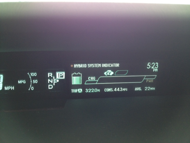

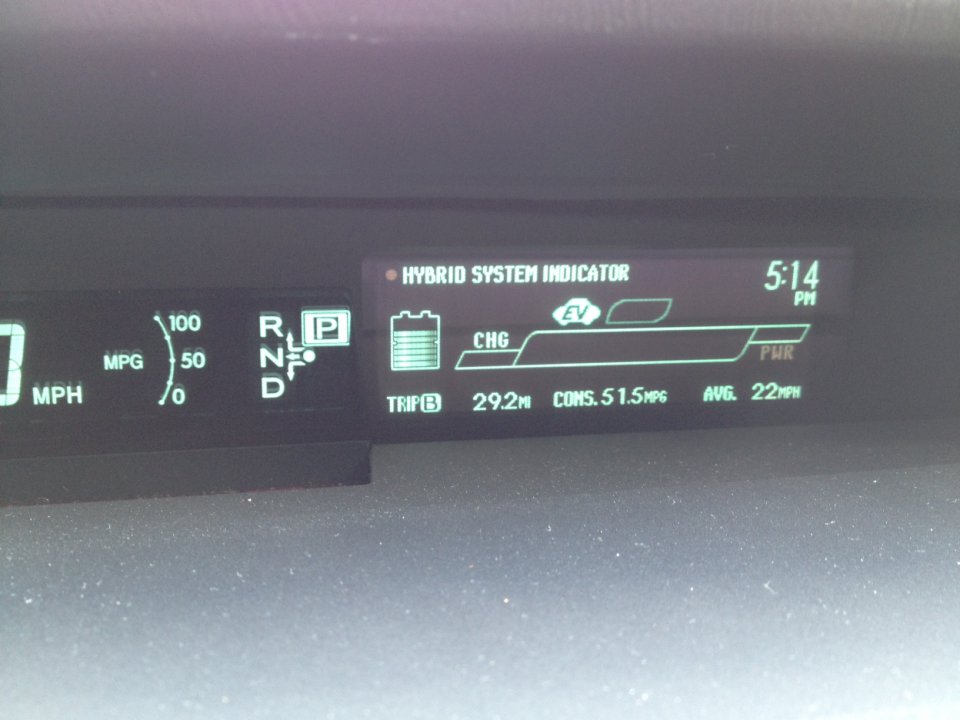

    bp.jpg update.according to my dash read out my mileage is improving..
    BUT according to the gas pump it is confusing ..
    ANY thoughts.
    MOBIL that I used to trust ..now Im questioning.

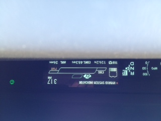

    bp.jpg sorry I don't know why the dash from BP is upside down
    but the mileage is 126.2 CONS 48.3 put in 2.78 of gas
    so that would be 45.39.
    why are there such a discrepancy in values??

    The actual mileage is usually 2 to 4 mpg lower than the HSI display.

    Just a note, unless the engine air filter is extremely plugged, it doesn't make a difference.
    Remember that with small tanks, you're increasing the margin of error. If the pump stops a little earlier or later than usual on a 2 gallon fill, it'll make a lot bigger difference than on an 8 gallon fill.

    The last photo in your previous post shows the car was turned upside down:

  16. Eve
    Eve Junior Member
    May 3, 2008
    59
    S.Florida
    :p bob that always happens when I take pictures standing on my head:giggle:
