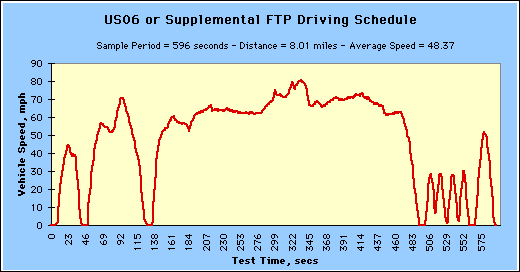

    Weight really does become a factor when you introduce rapid changes in speed. The EPA tests do not use rapid changes of speed, the acceleration on the highway test is roughly equivalent to an 18 second 0-60 if I recall correctly.
    The US06 "aggressive cycle" reaches 80 mph:
