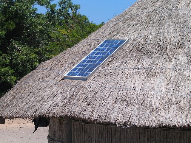

    IMHO, it is only a matter of time before we see EV technology show up on farms and rural areas. If it happens first in China, India, Africa, and South America, fine by me. With on farm energy generation by either solar cells and/or wind, no problem for me. But I am reminded of solar cells powering cell phones:
