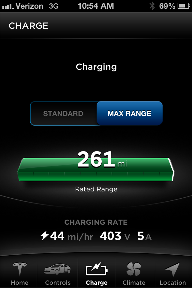

    I don't remember. Here's one I just googled:
    Motor-battery combo performance differences S60, S85, and P85 | Page 2 | Tesla Motors Club
    "While Model S supercharged at Refuel, I noticed a 60 kWh model tapering current to 32A at 352V while the 85 kWh model was finishing at 37A and 402V. These were values indicated on the dash.
    402V / 96 cells is 4.19V and that makes sense for top of charge."
    Same thread:
    403V / 96 cells = 4.198V per cell.

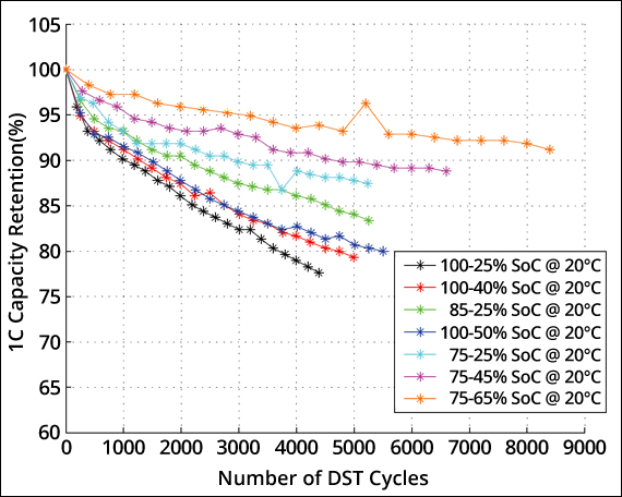

    It's widely accepted that the maximum you should charge a Lithium Ion battery to if you want it to last thousands of cycles (as opposed to hundreds) is 4.05V per cell.
    How to Prolong Lithium-based Batteries - Battery University
    "Table 4: Discharge cycles and capacity as a function of charge voltage limit. Every 0.10V drop below 4.20V/cell doubles the cycle but holds less capacity. "
