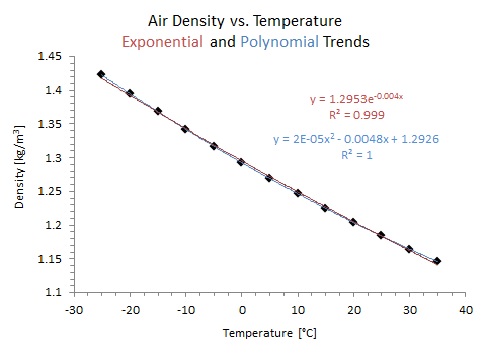

    Added air density? I don't think it would have a measurable impact unless at high speeds. Do we have any experts in that field?

    Not an expert, but I imagine the change in density is the inverse of the ratio of temperatures on the Kelvin scale. Since overcoming air friction is about 50% of total energy use at 70 mph (110 kph), this suggests that a drop from say 30C to 0C would increase fuel consumption about 5%, all else staying the same.
    Of course the colder temp also increases oil viscosity, so the effect of cold goes beyond rougher roads and heavier air to push around.

  12. SageBrush
    SageBrush Senior Member
    Jun 4, 2008
    11,627
    2,533
    Southwest Colorado
    Google agrees:
