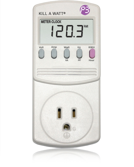

    Pretty much the way you tell is by putting its rated voltage across it, measuring the current that flows then once it has stabilized, and multiplying the volts by the amps to get the watts.
    If you have a handy little gizmo like the Kill-A-Watt, you plug the lamp into it, turn it on, and read the watts. :)

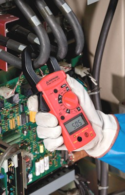

    Sounds like a good excuse for an amp meter probe.

    Sure, but the needed toy count starts clicking upward soon enough.
    Maybe you start with your amp meter probe.

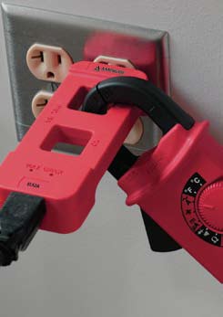

    But then, hmm, the cord to your light fixture has the gozinta and gozouta wires right next to each other. You can't just put your clamp over that, they'll cancel and always read zero. So are you going to slit your lamp cord and pull the two sides apart, so you can get your clamp around just one of them?
    Who wants to do that? So now your toy list needs a clamp probe line splitter.
    Before you know it, you've accumulated more toys than you'd have if you just had one Kill-A-Watt and plugged the lamp into it, and read the watts off.

    Wattage is the product of voltage times current. So you put the thing on its rated voltage, measure that with a voltmeter, measure the current at the same time with an ammeter, multiply the volts by the amps and boom, watts.
    A voltmeter has probes you can just poke across something, easy. An ammeter has to be put in the current path, so as a practical matter you'd end up unscrewing something in your light fixture to wire the ammeter in, or wire up a plug and socket you can put between your fixture and the wall that diverts your current through the ammeter. Or you can use the kind of clamp probe shown in #6, but even then you still have to separate the two wires in your lamp cord, or plug it into the kind of splitter gadget also seen in #6.
    So that's what makes a little gizmo like the Kill A Watt (also seen in #6) so handy. You plug it in the wall, plug your lamp into it, and it measures both the voltage and the current at once and multiplies them for you and shows you the watts.
