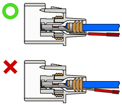

    At the risk of sounding silly, the wire is, of course, insulated. You can't just put a meter probe "on" it just anywhere and get a reading. You need a place where you can probe the copper. That would be at the water pump end, or at the ECM end (and both of those ends have waterproof terminal seals you would need to get around with a backprobe), or at the DA2 connector in the fusebox, or some place where you scraped off or pierced the insulation (not recommended). We can't follow along with what you're doing if you're too vague.
    You already know where the water pump relay is, right? Relay blades 3 and 5 are the switching contact ones (1 and 2 are the coil), as shown in the diagram. I'm pretty sure the coil terminals are a bit narrower, if you're not looking at a drawing or seeing numbers molded in.

    No offense taken. Because PriusChat threads become permanent resources for others, it's still possible I might chime in from time to time to clarify things that could throw off future readers with similar issues, but otherwise I'll leave the lifting to others. Here's to swift resolution of your issue.
