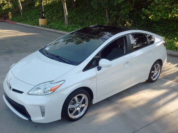

    The springs make it look cool but trying to get a jack under it is not cool. LOl

    Mike's car finally looks good :cool:

    If you look at it from this angle the gap isn't so bad. If I was this tall I wouldn't even thing about lowering it. :p
