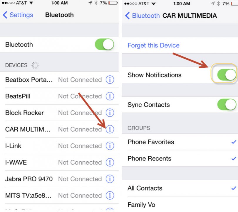

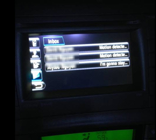

    You'll need to enable this on the phone first.I have a Gen3, iphone 5, IOS 7
    Go to your iphone. --> Settings-->Bluethooth-->Car Multimedia . Hit the info icon and turn on "Show Notifications".
    Then when you get a text, if you hit the (Answer Phone) button on the Prius steering wheel, select the mail icon and you can select the message and the speaker icon to read it to you.
    If you leave it on the mail screen, it's safer obviously so you don't have to go through all those steps, but it does beat trying to read it off your phone while your driving which is totally not safe.
    Also if you just driving, it will say "New Text Message" it would be cool if it just read it outload, but then again if you have someone in the car you may not want that.
    I do have to admit, I love hearing my wife nag at me in another Siri like voice :LOL::LOL::LOL::LOL:..
